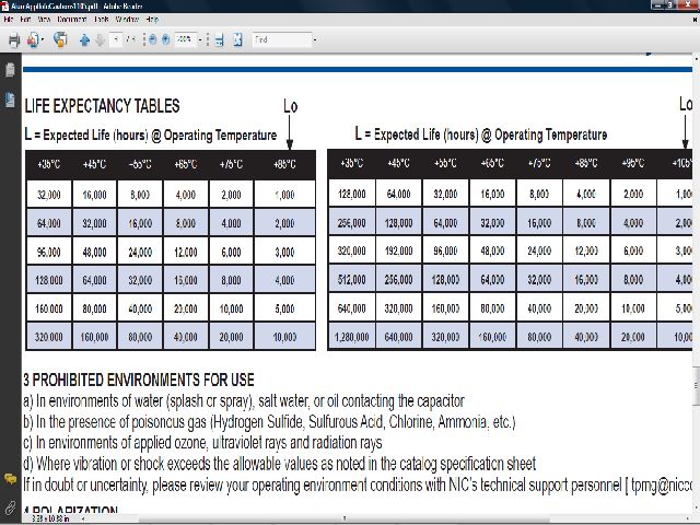

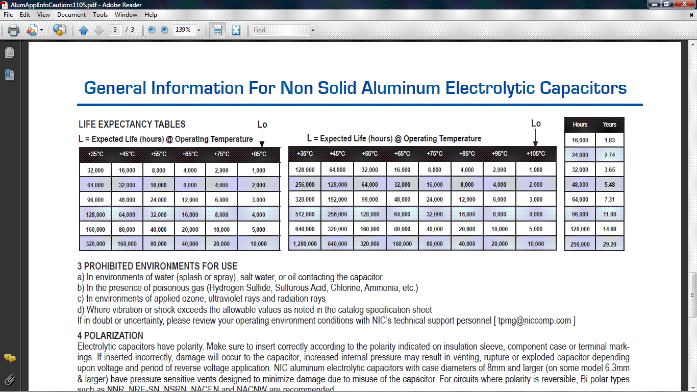

Posted: Wed Nov 11, 2009 1:05 am    Post subject:
draganm wrote:
again, from the article. For every 10 degree Celsius drop in temp. and 20% drop in applied DC voltage life is doubled. so if it's an 85C 100 volt cap rated for 2000 hours and it's run at 45C and 50 volts it should last approxiamtely 7000 hours and still operate within it's rated capacitance. After that internal leakage would presumably start to increase.
For every 10C drop in ambient temp the rated life is doubled is correct. Where your getting that 7000 hour figure at I dont know. Every chart I've seen shows like this.

In the chart below note the lines marked 1 and 2. These would be 85 degree C, 2000 and 3000 hour rating. If you follow the line showing lower ambient temperature of use you will see that if being used in an environment of approximately 45 degrees C (projectors are mostly under this temp) the minimum life expectancy should be 40,000 to 60,000 hours.
