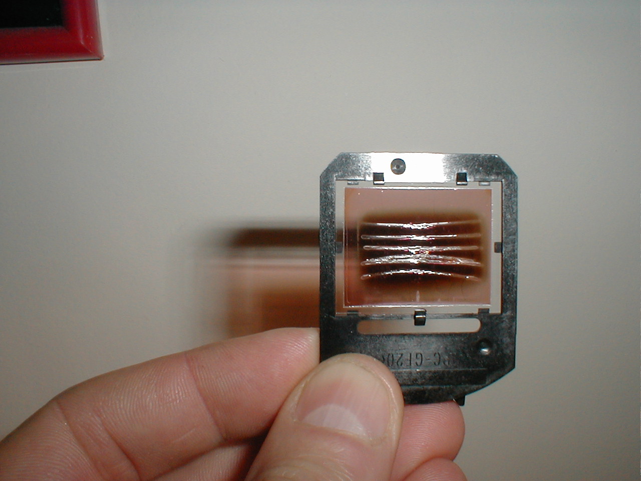

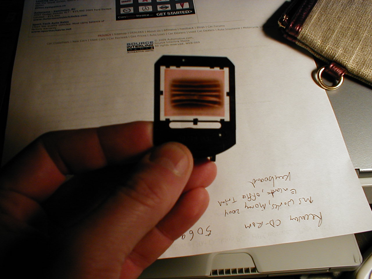

Hope everyone had a great christmas! - New Years Eve is now looming. Didn't have any time to play with this set for more than 6 weeks, til now...with all the christmas shopping and mayhem...yesterday one of my sons helped me remove the screen, I dug deep into the light engine and found my major / last problem. The super thin tinted mica filter in front of the blue LCD is badly damaged , sort of toasted looking with horizontal crazing. Crying or Very sad and of course I also found the air filter on the bottom of the light engine was plugged...the root cause.
Attached a couple of pictures... my headache now is trying to find one of these filters by itself. The service manual doesn't have a listing for this as a separate item that I could determine. Partstore and Vance Baldwin don't list anything I could clearly identify....other than UX22811 "panel filter assy".
Mac do you know if these are available anywhere, and if not, are all these filters tinted the same colour ? Then I could try my luck getting a dead light engine off the 'Bay and scavenging a replacement filter.

The correct part name is polarizer. And no they are not available. Your only option short of a rebuilt light engine is to find a used one.Thing is, this was a very common problem on these engines. The rebuilt replacement engines have been redesigned with multiple filters and a temp sensor to shut down the engine before it gets so hot that it melts the polarizers. Yours is probably an original with only 1 filter. So even if you find a used light engine, you would be gambling if it has good polarizers or not. You may want to check with a local TV repair shop to see if they have a used engine laying around that you can check for a good one. I'm pretty sure the polarizers are NOT the same for the 50V500, but you would have to verify. Other models may be the same, but not sure.
Most of the time though, the original was returned as a core for a rebuilt one so there may not be many laying around, unless a customer decided not to spend the money and just left the set there for parts.
Posted: Thu Dec 31, 2009 7:09 am    Post subject:
These should be compatible models: 50VX500, 50C10
