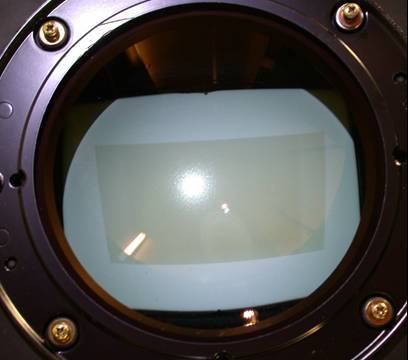

I found the 4,000 hr G90 in New Jersey and had it shipped to me in TN. It arrived safely yesterday. Of course I was hoping for the best. The case is in near mint condition. However the green & blue tubes will have to be replaced due to improper setup. Fortunately I got the projector at a good enough price I won't have "too much" in it after replaing the tubes.
The projector came out of a home theater were it was originally installed about 10 years ago. I find it amazing someone would purchase a $43,000 projector but not have it setup properly.

Posted: Wed Sep 23, 2009 5:15 pm    Post subject:
Wow, another G90 owner! Congrats!
After seeing Art's and Cliffy's stacks, I can tell you you're going to be thrilled going from a G70.
New green, tube... STAT!

I have to agree! The problem is, the customer was not properly advised on the importance of getting it set up by someone who knew what they were doing. Or the company that sold it to him ACTUALLY did do the set up and it's obvious that they had no idea what they were doing. Provided that there weren't any mounting distance constraints due to the room layout, these people weren't even aware of PJ Calc!!!! Totally incompetent and a dis-service to the HT community......what a shame. If you are going to order a tube or two, I would advise you to do so through Greg Eisemann. He has the best grade tubes at the best pricing available.

What is wrong with the setup? It looks ok to me........
If you don't think there is enough raster usage, you'll quickly find out if you go any further, your corner focus will suffer. If I remember correctly, that is about the raster usage I currently have.

Another problem however is that if you look at the raster pattern you can see a 4x3 inside the 16x9. That is going to show horrible burn in for 4x3 when watching 16x9.
A tip for getting better raster usage on a G90 is to tip up the back of the projector a little. I usually tip the back up about 1.5" ~ 2.0" and this makes for less keystone correction so you get more of a square raster. That way more phosphor gets used and you will also find that the corners on the short side will come out sharper Smile
craigr
I did this with my 1209s. Being ceiling mounted I actually tilted it down in back a little to get the tube faces closer to the same plane as the screen to minimize the keystone. Thumbs Up

Cliff when you say the corner focus will suffer are you talking about the lenses or CRTs ?

This is a question I had confronted with my BG1208 when I installed HD-145s. I maxed the raster with the lenses off, then I had to make the raster smaller to fit within the range of the lense(s).

How come the green doesn't have a (lightly) filtered C-element?
YEAH!!! WTF???
Does it just look green and the photo didn't get it?
I'll let you know when I get the cores from betel what it looks like compared to the normal Sony style.
