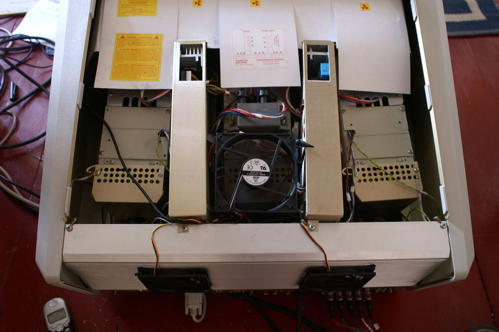

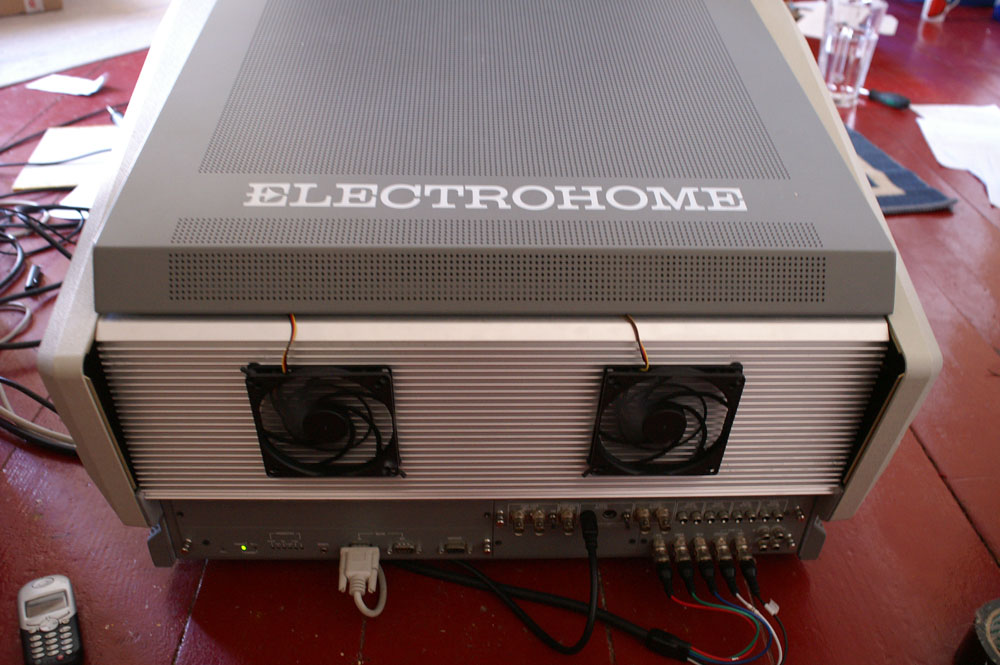

Hi, i moddes something again!
The Bellyfans ran on 10,7 now and i added another fan on the green tube to "squirl" the air thought the PJ (because the airflow of the Bellyfans isn't enought). At 5V it's not audible but you can fell that the PJ is colder now. It's fixed with old Bike tire tubes.
Then i added two very thin small fans on the heat sink in the back. These Small fans @ 5V gave at least 5-10°C less heat sink temperature.
A Question for the NEC users: My PJ is factory color calibrated. Which possibilities do i have in the OSD to calibrate the white balance "better"? Is there a description for the WB aviable in the WWW? Do someone have a Service Manual for me?
I am still waiting for the Arctic Cooling Fan for the NEC.

Posted: Sat Sep 26, 2009 5:45 pm    Post subject:
Yeah lets put a magnet field generating fan right on top of the tube neck and screw up the astig. I wouldn't go that route.

Posted: Sat Sep 26, 2009 5:58 pm    Post subject:
Sorry, but i think it's voodoo!
Yes of cause it's a rotating magnet field, but on of which dimension?
The permeability of the iron in the rotor is at least 1000 times higher than the permeability of air. So the magnetic field won't go into the air around. The rotating field of the Fan windings isn't big to (and doesn't come out to).
If i ran the fan at 20000V (sorry thats really a bit ironic) the circle currents induced in the iron of the neckcover will be so high that it tourns into red!
I tested something to be shure:
I put a neodym magnet on another Fan, the force is only big in the middle of the Fan (to the axis).
Think about the deflection Cables! Very high currents at high frequency. As higher the frequency as higher the ability to tunnel through the little holes in the Neckboard Cover.

It's not voodoo. Some fans are designed to contain the magnetic field, some are not. It is easy to test, project a crosshatch test pattern and move the fan in question near the tube neck. Some fans will cause the image to move, some won't. One test is worth a thousand opinions.

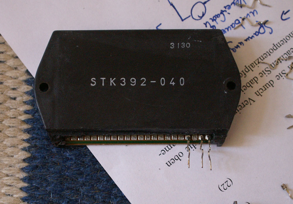

I've got some problems with the NEC. I changed the deflection and convergenz Cables for desk front projektion and now the convergence on green and blue switches off and on and of and on. I think it will be a bad soldering, because it comes along with shaking the board.
I'll test the fact with the Fan. Sorry for my theory, there must be something my actual electrotechnics and physics study is good for, at least for beeing a wisenheimer.

Posted: Sun Sep 27, 2009 10:35 am    Post subject:
I resoldered everything on the board. Nothing.
Then i deform the pins of the stk's to the chip (when i deform the hole pcb to the chip it works too). Now everything is "fine" again.
Is it possible to resoldier the pins of the stk's internally?
Ohhh it is. Lots of work desoldier the stk and at least half of the pins were easy.
Any ideas?

Posted: Sun Sep 27, 2009 11:33 am    Post subject:
I opend the chip with a saw! But then i noticed that i must soldier very hot because the heat sink steals the heat from my soldering gun.
Then i noticed that the chip isn't expensive and i ordered one on ebay!
I noticed that one side of the Alu-heatsink of the convergence board was not connected right to the bottom of the chassis. This might be the reason of desoldiering!
 Filesize:  144.1 KB

Posted: Mon Sep 28, 2009 2:45 pm    Post subject:
you probably ordered a new stock (or fake) chip on ebay.
Only the old stock chips are of high enough quality to withstand the stress in a PJ with maximized rasters. Those are hard to come by and typically way more expensive though.
Most people would use replacement boards with known good chips on them.
You can ask if you need one, as I can see that you are in Germany as well.
