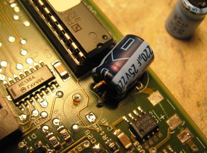

here's another one. Marquee control module problems last couple years have been rather common. It used to be you could just pull the socketed chips, clean them wtih de-oxit, and evrything would be fine. Not so sure anymore? This is the deflection processor daughter board on the CLM, one of the two 220uf 25V caps. I like to replace these with Nichikon 220uf 50V HE series. Needless to say when this board starts to fail you will get all kinds of wierd anamoly's in the image as well as random shut-downs from scan failure detections. This a 1996 8500 with 2500 hours on the clock from florida,though the hour counter might have been re-set.

Posted: Wed Mar 10, 2010 6:06 pm    Post subject:
Drags, just curious, I'm not used to seeing heat damage on the legs like that unless it was from serious heat from a soldering iron. What are you using to rework boards? I also some others where pads pulled off or the solder snapped off the pad cold. Are you using a rework station? What do the top of the cap bodies look like

Posted: Wed Mar 10, 2010 8:41 pm    Post subject:
Not sure what you mean by "heat-damage"? The brown colored residue is corrosive eletrolytic that has leaked out of the cap.
