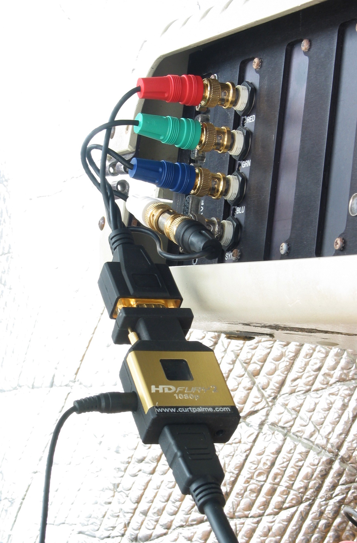

Try this: Do you have an RGBHV cable for the HDFury2? IF so get a BNC T adaptor and hook the HDFury2 to RGBS, T'ing the H+V leads together.
 Filename:  RGBs_9263.jpg
 Filesize:  498.43 KB
 Downloaded:  381 Time(s)

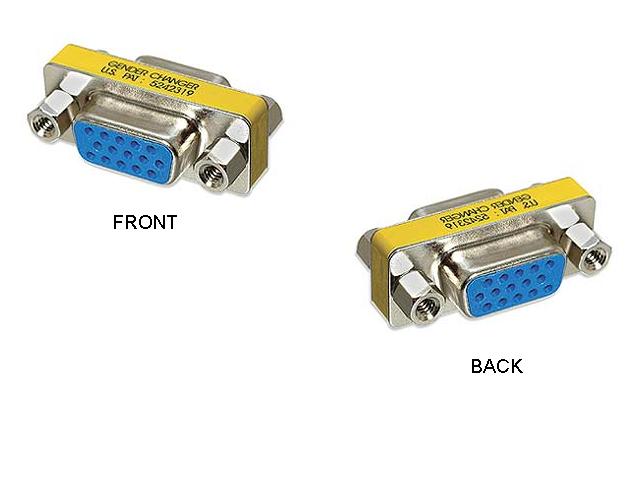

Ever notice how impossible it is to remember every little thing when describing anything? I forgot to mention that the breakout cable (VGA to RBGHV) connects the box 2220 which is located behind me in the next room to the projector for a total of about 15 feet. Weak signal might turn the ampro into a big heavy clock. May I assume that other people have had this problem to the extent that a "cable driver" is the cure?
This would be a whole lot easier if the fury had the opposite sex output connector.
Posted: Thu Nov 12, 2009 2:08 am    Post subject:
416ray4538 wrote:
stefuel wrote:
Describe the way you have it connected. It sounds to me that you have a sync problem. Are you using RGBHV or are you trying to just use the 4 connections on the RGB1 board.
Stop by a local computer store and grab a gender changer for $5. I use them all the time.
 Filesize:  25.58 KB
 Viewed:  7322 Time(s)
