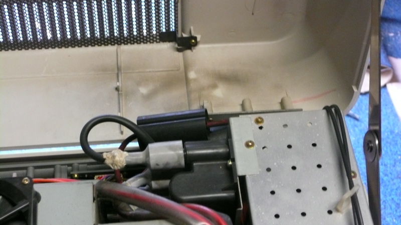

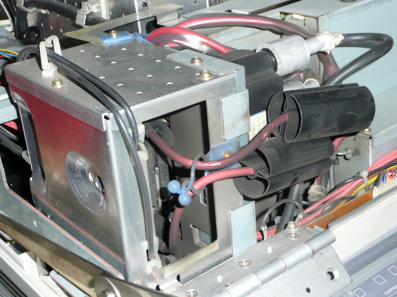

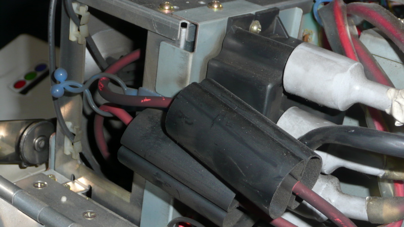

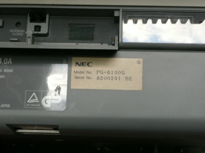

Posted: Sun Jun 28, 2009 1:42 pm    Post subject:
Here are some pics of the damage

Posted: Sun Jun 28, 2009 2:07 pm    Post subject:
LOL, wrong powersupply.
That's not damaged, that dirty soot is normal around the HV supply.
The supply you want to look inside is under the lenses.
Oh, and Curt, I have no PG parts at all.
I only have my spare set (much travelled) of XG-1101LC boards. Nothing else.
Oh Oh, and Curt, it's 240v here, but NEC just made a generic 220v supply which runs fine on 240v.
