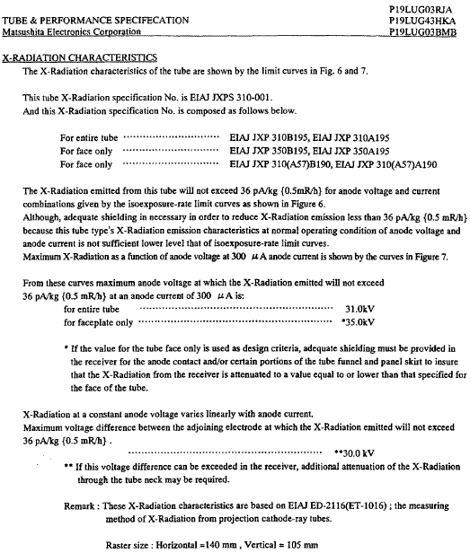

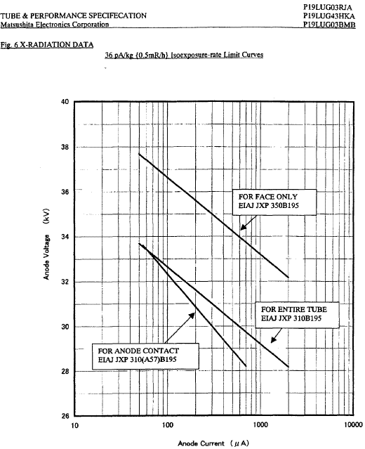

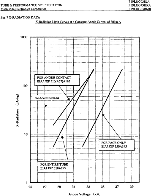

The projector manufacturers added shielding as they thought necessary. There were probably some sort of government standards to meet. You can look at the followig attachments to get some idea of what the tubes produce. You may as well figure the anode voltage is +35kV. The anode current is typically 1000uA or less. As mentioned previously dense materials do attenuate the XRays as does distance. Some Wikipedia searching might give some ideas as to how much is acceptable.
Scott
 Filesize:  26.64 KB
 Viewed:  7684 Time(s)
 Filesize:  29.62 KB
 Filesize:  29.86 KB

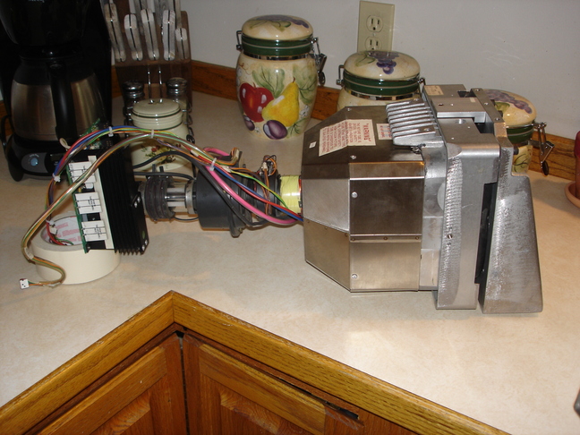

Posted: Sun May 17, 2009 8:26 pm    Post subject:
That should about do it Cool

Posted: Sun May 17, 2009 11:33 pm    Post subject:
That is frikin' beautiful! Now, use the Marquee method of grounding the external dag. Copper tape on the dag, cable from there back to the spark gap ground on the CRT card then a cable from there to the chassis.. Don't ground it to the housing.

Posted: Sun May 17, 2009 11:57 pm    Post subject:
tse wrote:
Scott
What is the "Marquee method"? The X-ray shield I used has a four finger isolated spring contact ground that makes contact with the tube bell then goes back to the crt card and then to the chassis ground on the mother board. Is that not good enough. Where would I get copper tape to do it otherwise?
That tube assembly is made up with a Thomas tube. It was a little tricky rewiring the neck board socket for it to work but it should be OK. It will be interesting to see how well a 4600 will optically focus up with Marquee optics and the high rez Thomas tubes.
