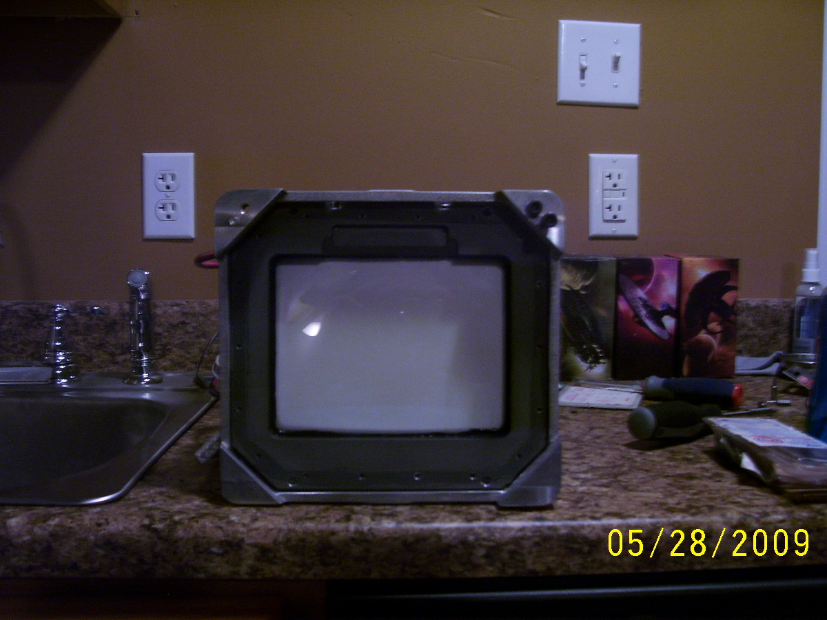

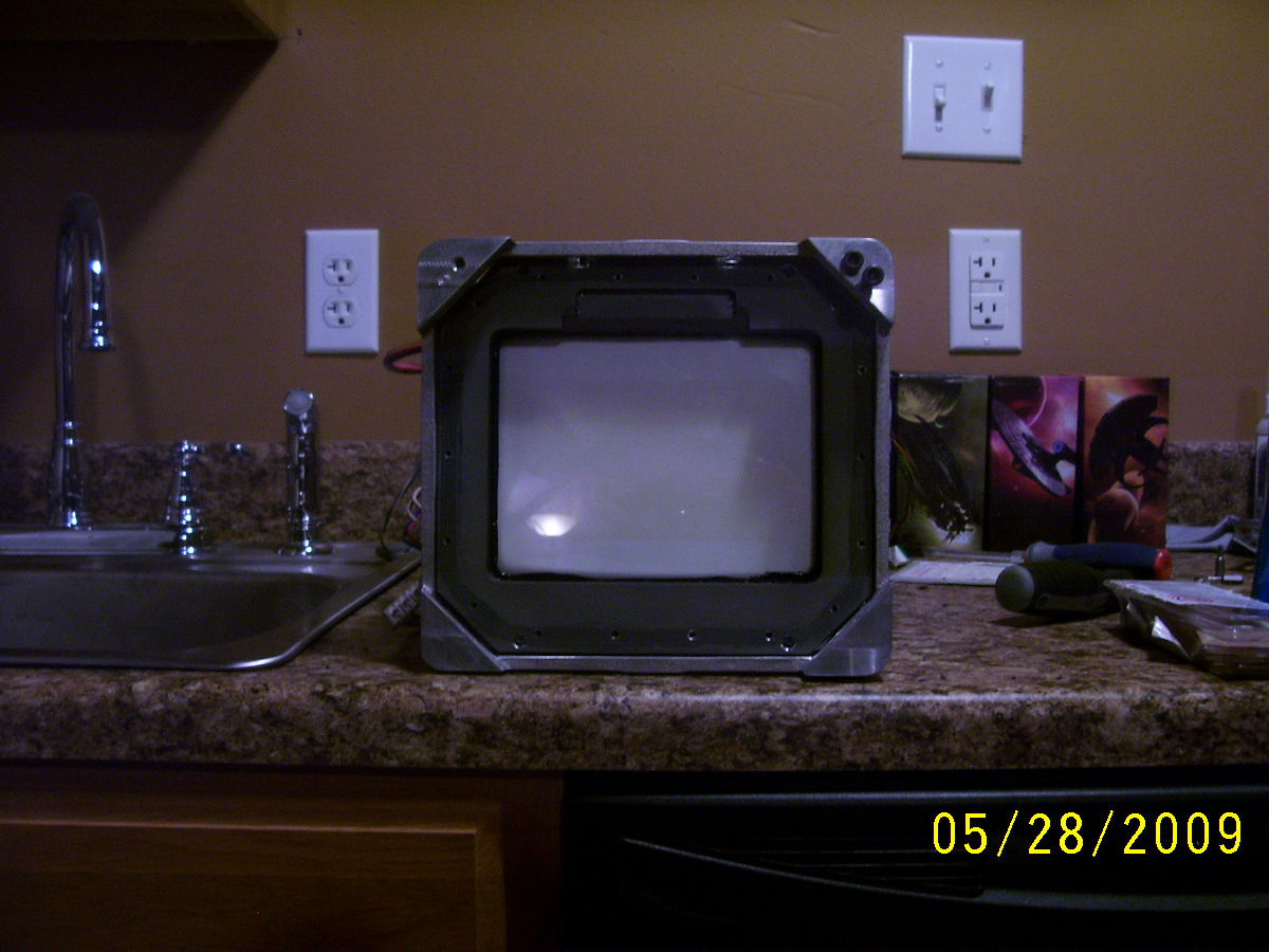

Back on topic.
The Red tube has been sitting for nearly a week now and no leaks. Time to put it back in GOZER and see the improved red. I also ordered the other 2 bellows from Nashou. I had so much fun on this one why not press my luck?
That's not sarcasm it was fun. I enjoyed it. Like I said earlier it is done and finished, so I feel like I accomplished something. Mr. Green

Posted: Wed Jul 01, 2009 9:10 pm    Post subject:
GOZER'S GREEN An 8? or 7?
 Filesize:  334.7 KB
 Viewed:  4195 Time(s)
 Filesize:  335.57 KB
 Viewed:  4191 Time(s)
http://www.hulu.com/firefly
Posted: Wed Jul 01, 2009 9:19 pm    Post subject:
7.5
