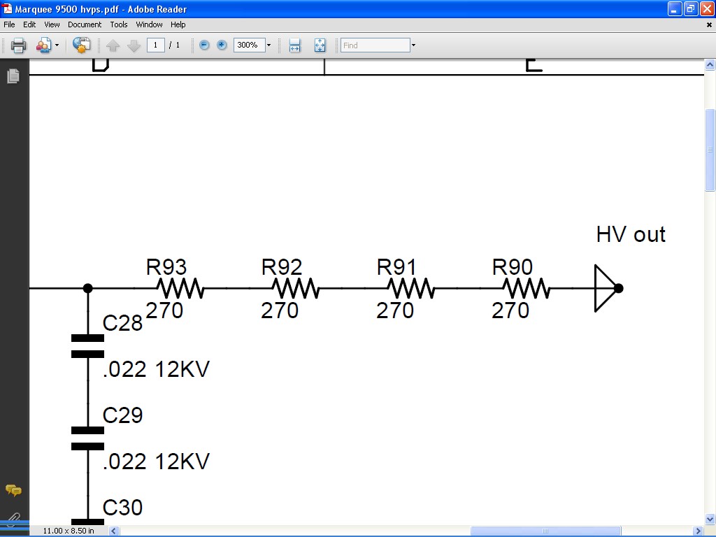

Posted: Wed May 13, 2009 3:08 pm    Post subject:
1031 wrote:
macgyver655 wrote:
Wonder why a resistor wasn't placed at the output of the P/S instead of in the splitter. Then the main line would be protected also.
From my memory there, is some series resistance to HV out lead at inside of HVPS.
I believe this is what your talking about. Very low ohm compared to the splitter ones.
