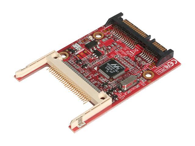

Here's a SATA to CF adapter...39.00
I'd rather slap a cheap SATA hard drive in there....
http://www.addonics.com/products/flash_memory_reader/adsacf.asp

I'd rather use a CF card, no moving parts and it doens't make any heat. Plus if I can find just the right board it'll already have a CF reader wired into the IDE port.
Posted: Mon May 11, 2009 7:34 pm    Post subject:
Absolutely! When the notebook drive in my old PowerBook G3 home automation computer finally dies, I'm going to slap an ATA CF card adapter in there, throw an 8GB CF card in and have a low-power, no-heat, totally silent boot drive in there. The computer has a tiny fan, but it never runs. The drive is getting noisy now, but when I put the ATA card in there, it will be perfectly silent... Silent as in literally zero sound emission.
Here's an SATA2CF adapter:
There are the same for PATA, too.
