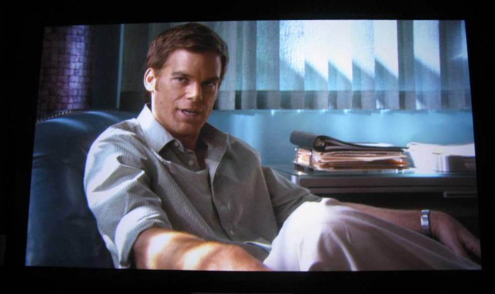

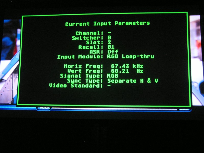

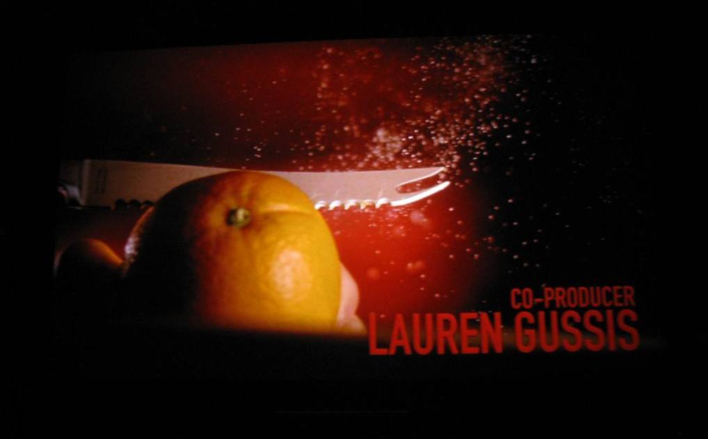

A few people have e-mailed me asking for screen shots to try and get an idea of "how much better can my marquee look if do this" etc. My photography skills are awful but last night while watching a show with my wife I paused it occasionally and took some shots. This is my personal 8500AC w/HD8 lenses on my Draper Onyx M1300 92 x 52 inch viewable. PJ has the HD mod's package with CLM re-build and some very old first Gen. MP VIM and neck-boards. Resolution is 720P direct from Blue Ray @60Hz, no scaler. I am basically very happy with the pic from this machine, and it looks much better in person of course.
It's nothing fancy, it's basically me sitting on my couch and pointing at the screen with the camera in my hands, no tri-pod as I don't own one. Camera is a $125. Canon A720 set to "TV mode" which is basically just flash off and "shutter priority". I'm not sure what that means but I think it sets the shutter to the fastest speed possible so you don't see the beam-retrace. Anyway, I think it shows CRT's awesome black levels, natural flesh tones, good colors etc. I wish I had taken some shots of outdoor scenes but my wife was getting annoyed as I kept interrupting the show.

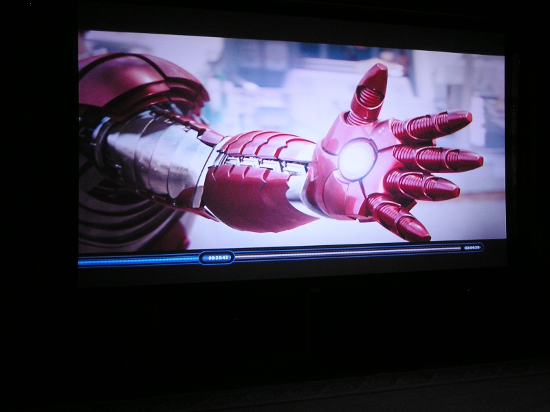

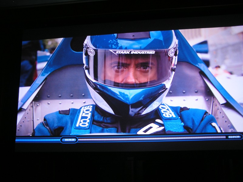

I've never been able to take good screen shots so this is from Paul in WI with a standard 8500. I actually sold this machine to him back in the day and was able to do the HD mod's on it recently as well as fix a synch issue on the CLM (needed re-capping). 1080P at 60hz direct from Oppo player to Moome V1.3 MP modded card. Anyone who says 1080P doesn't look good on an 8 inch machine just needs to chill-out. Wink
a follow up feedback
I just watched Armageddon in 1080p! I never saw it in the theater but I felt like I just did! Even a 12 year old movie can look great. The close up shots of peoples faces are very clear and detailed even with my novice set up, this is a huge upgrade from what I was watching before. Worth every penny I've spent...so far! Smile

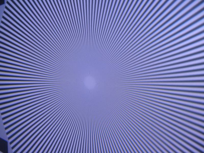

Also, to replace the CL449 buffer / amp at U11,17, and 23 with a slightly more capable EL5166. Anyway, as usual here are some of my perfectly awful screen shots which none the less show the modest but noticeable results of step 1 from above. This is a standard air coupled 8500 with HD8 lenses at 1080P -60Hz.
