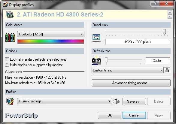

On this page you described on the left it states 1600x1200 max resolution. On the right at the top if I slide the slider it will only go to 1440 x 1050. It has 1920x1080 but when I slide it there and hit apply it changes back to the lower setting.

dvh99
Joined: 25 Dec 2009
Posts: 2158
Location: nederland
Posted: Sun May 09, 2010 1:51 am    Post subject:
i have that too but powerstrip overrides it.
you see the same with me 1600*1200
when you click on advanced timing options you will be allowed to set the desired resoltion and porch settings.
hope this helps.
dennis

In the advanced timing page can you set all of the numbers with out interaction? If I change one number it changes others.
dvh99
Joined: 25 Dec 2009
Posts: 2158
Location: nederland
Posted: Sun May 09, 2010 2:46 am    Post subject:
yes that is correct it interacts. just hook it up to the pj and change porch settings after you are finished set the vertical refresh rate to 71.976 or something (just 1 click below 72 hz).
