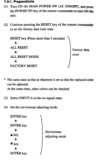

Per the FSM on how to reset to factory defaults...
 Filesize:  85.66 KB
 Viewed:  9635 Time(s)

On an earlier thread Axatax suggested "hit each registration button on the bottom of the remote, from CENT to ZONE, and return each setting to 128 manually.
If your PJ hours are true then you may have a completely original chassis. In that case I would do a factory reset, not a reset to 128.
