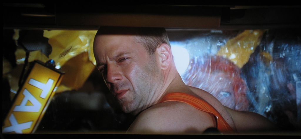

Posted: Sun Oct 17, 2010 5:02 pm    Post subject:
It's looking pretty good:
