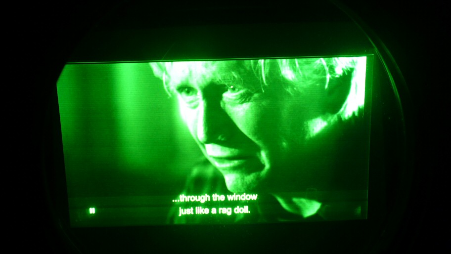

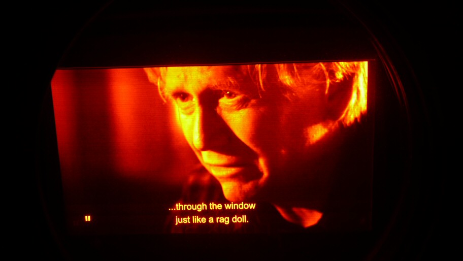

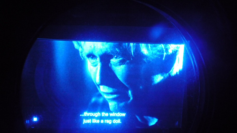

speedyandre
Joined: 18 Dec 2006
Posts: 291
Location: Netherlands
Posted: Sat Jun 13, 2009 11:37 pm    Post subject:
I've exchanged the blue neckboard because it's red wire was not strapped to other wires.
The difference is quite clear but sometimes I still can see a very light kind of streaking in the blue tube.
At first sight there is no difference in colour or brightness but I only can confirm this with some measurements Wink
I'm sorry for the blocks, they came after resizing and compressing the pictures Embarassed
André
