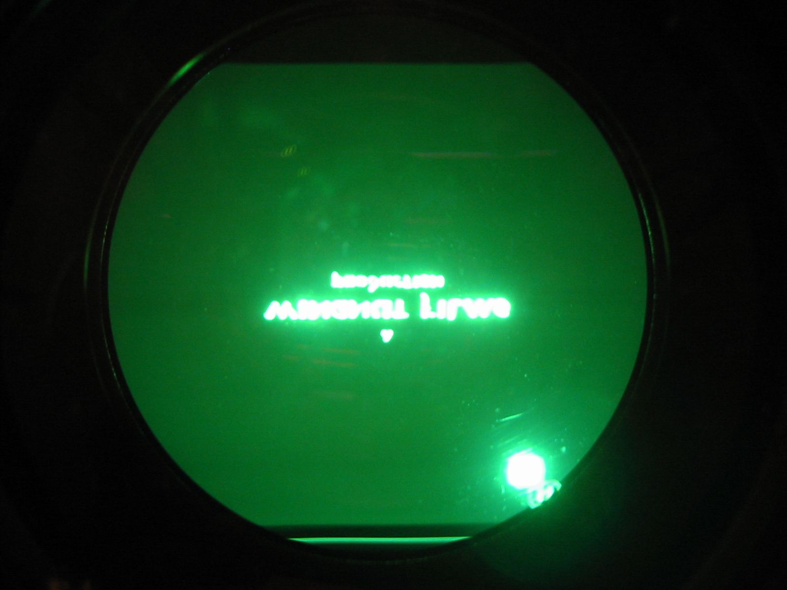

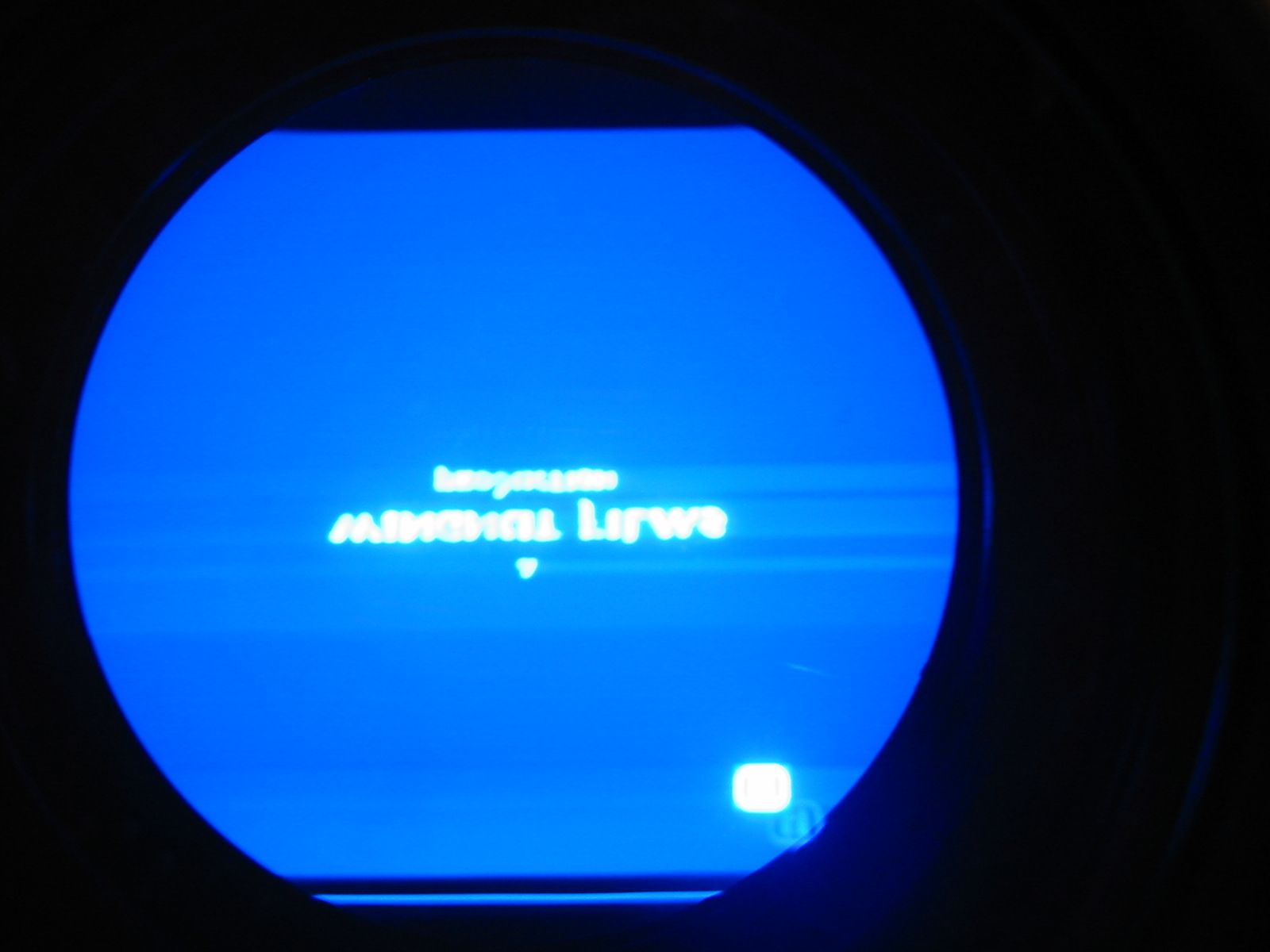

Pic of test material from dvd player; paused on text; projector brightness 70 contrast 80. The effect you see is happening all the time, to some degree, diminishing the overall picture quality.

speedyandre
Joined: 18 Dec 2006
Posts: 291
Location: Netherlands
Posted: Mon Apr 13, 2009 10:11 am    Post subject:
Did you place the mod on all tubes?
The pictures show streaking on the blue tube and it's gone on the green tube.
But the pcb mod is installed on the blue tube ....
I'm an electronic engineer so placing the mod myself and remove some parts on the neckboard is no problem.
Making measurements is possible too with my spyder, but I do not have much calibration experience Wink

Posted: Tue Apr 14, 2009 6:32 am    Post subject:
No he said he was going to remove the mod from the blue and leave it on the green to show the difference.

Posted: Wed Apr 15, 2009 11:41 am    Post subject:
Even better, I have a spare lot of neckboards so I can exchange the boards easily Thumbs Up
Did you try to stop the neckboard fans to check if your solution is temperature dependent?
André
A fellow EE, looking forward to working with you! Andre, can you post a picture that clearly shows the streaking? Something similar to my post. We have to establish a reference, something to compare after the upgrade kit is installed. We’re working with a tough crowd here!
