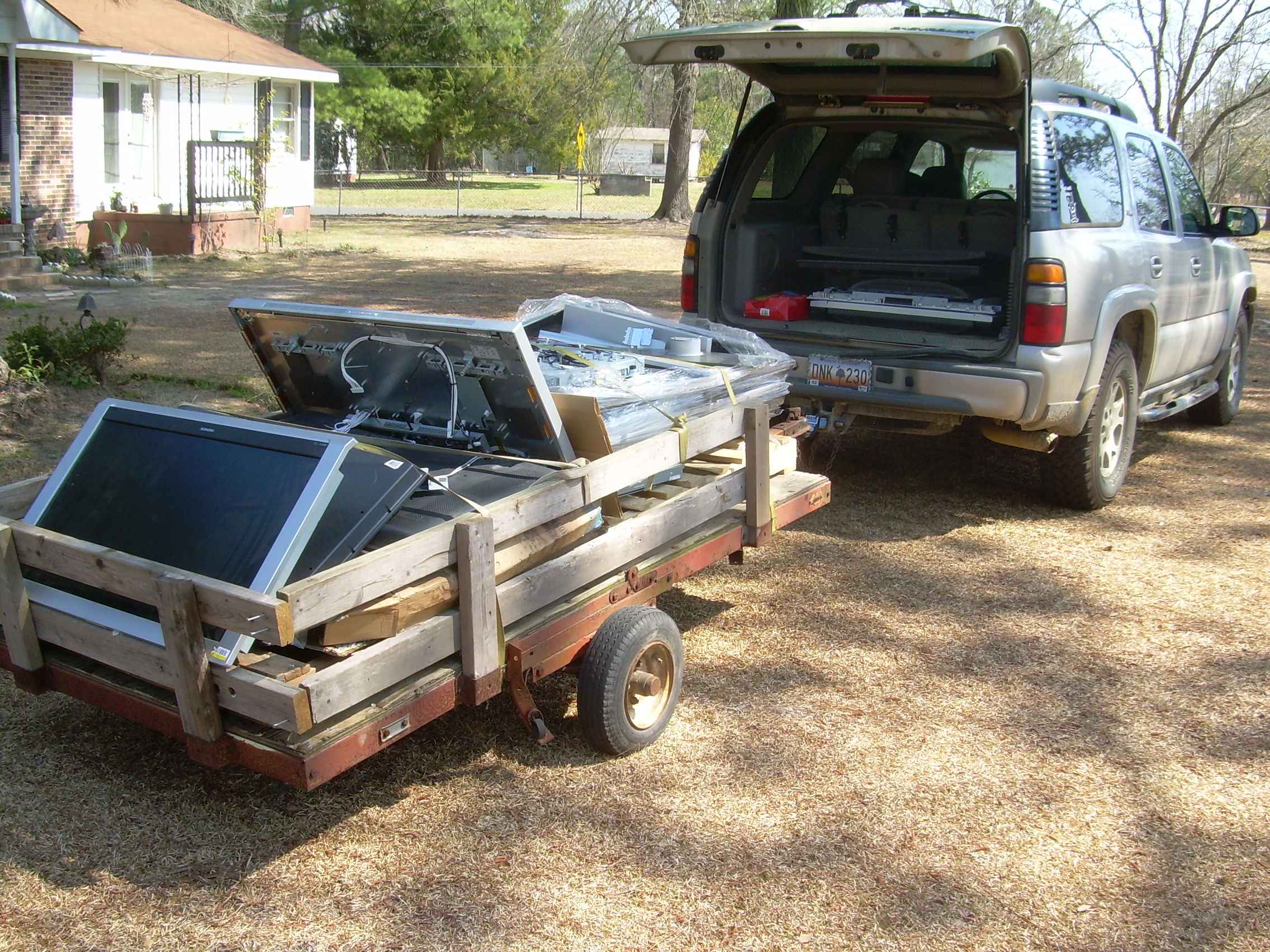

Well this is today's haul. Saw at least a few broken displays so I'll have spare parts laying around. Should be able to get a few working sets anyways. The price was definitely right. Suppose to be more panels to come. Smile

NICE! I'd like a local haul like that, I wanna try repairing them. Smile

So what's the usual issue with these? Power supply problems?
Well what do you know, KAL . First one I pull out of the pile to look at and its got a blown out power supply. You have some kind of ESP going on? Shocked
