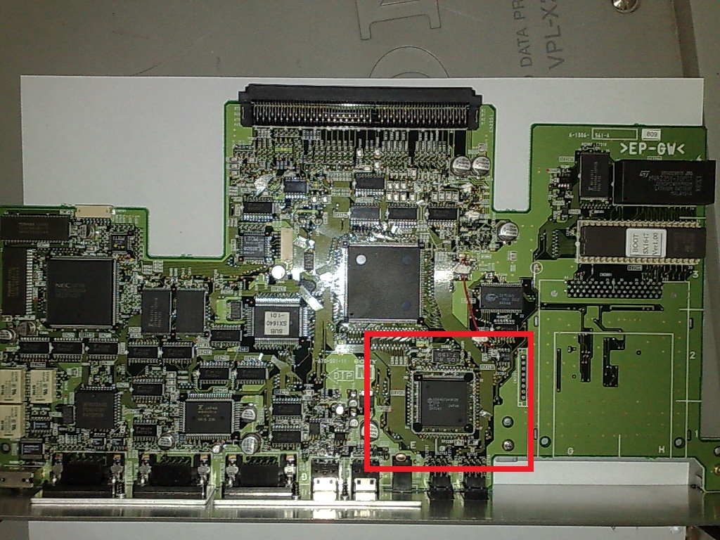

Could you please post a close up clear shot of the IC circled in red below? We don't want the parts from your projector, but if we can find a way to get more of these projectors, or the part from Sony, we may be able to save some G90 CRT projectors.

Native Res is 1024x768
The Projector is in situ at present...but check back often..I will try and get a better shot.

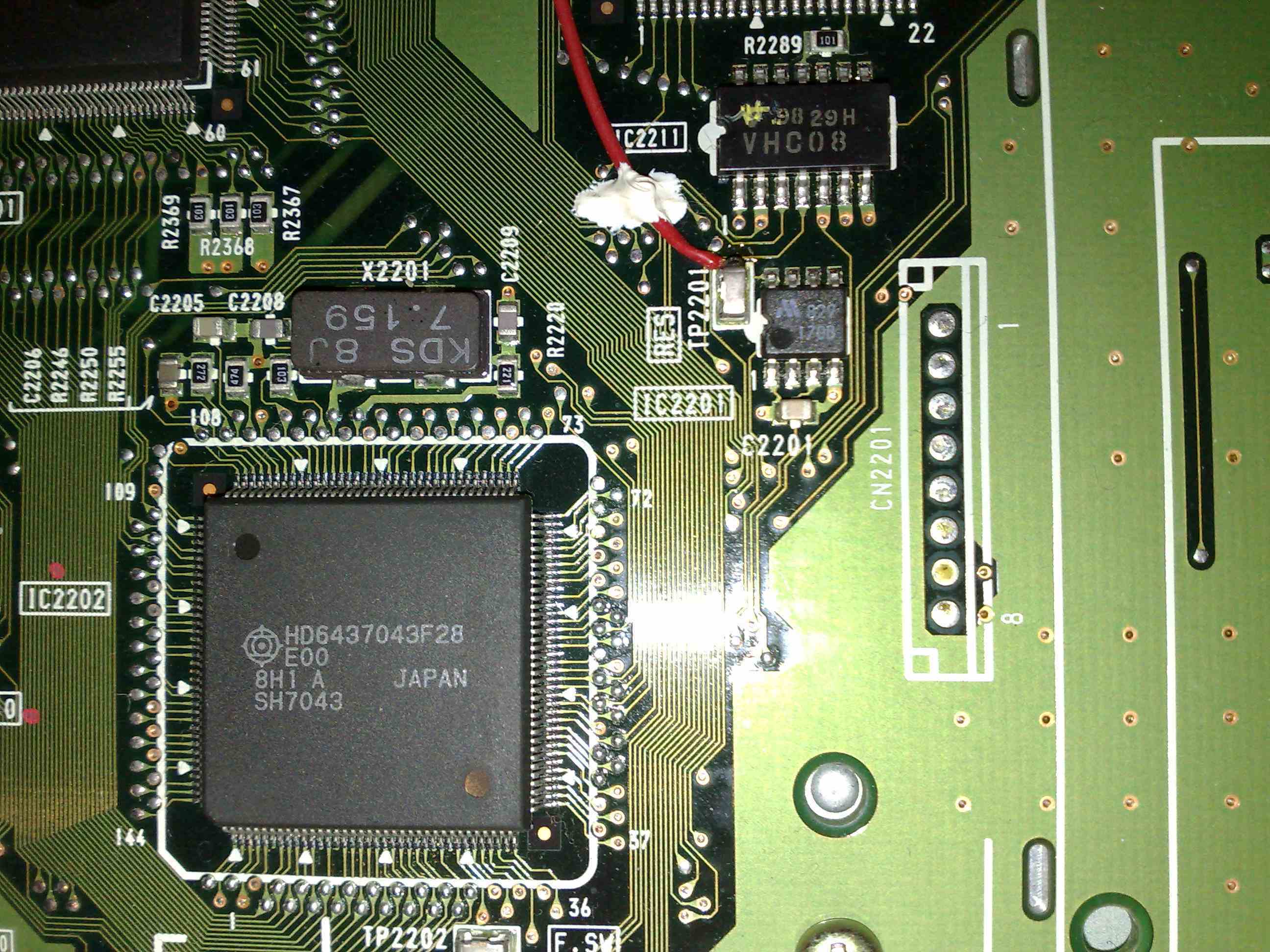

Close up of that IC you wanted Smile

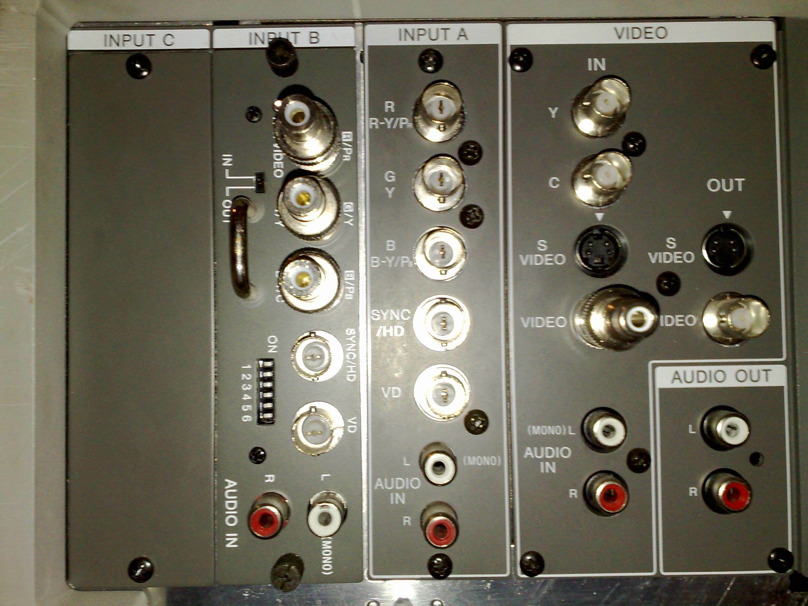

Just for Reference/Information --- here is a pic of the interface cards on the back of the SONY VPLX2000 see attachment
