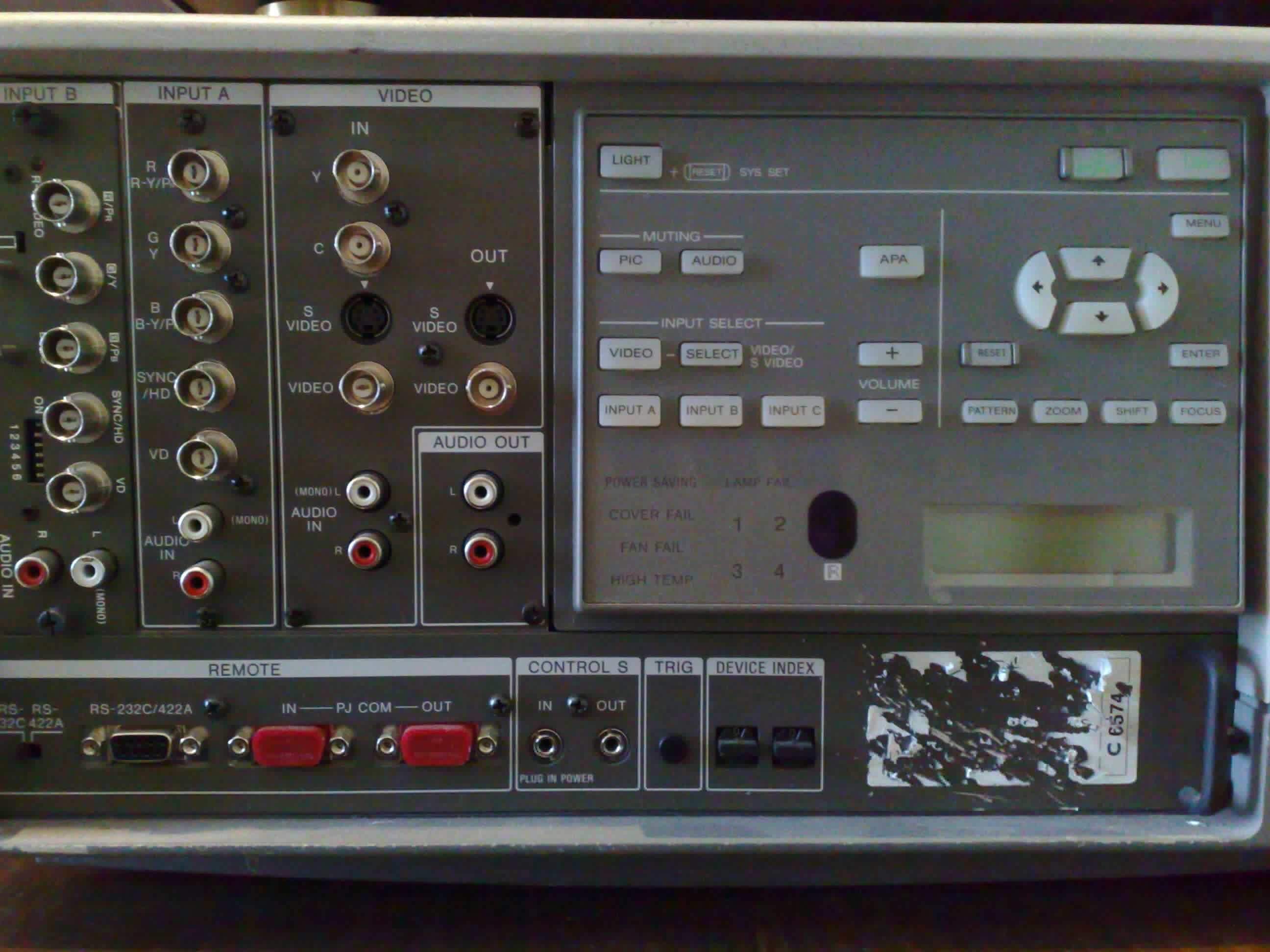

Can anyone tell me if the cards on my old Sony VPL2000M (circa 2000) Stage LCD Projector are interchangeable with Sony's CRT Projector's ?!
Please see pic
Cheers
 Filename:  sonyvplx2000m.jpg
 Filesize:  192 KB
 Downloaded:  568 Time(s)
Posted: Sat Mar 07, 2009 4:25 pm    Post subject:
Very possible. Input B looks exactly like an IFB-12 from the outside appearance. If you want to find out, pull the cards and look for the model number silkscreened on the boards, or take pics for us and post here and we can compare.

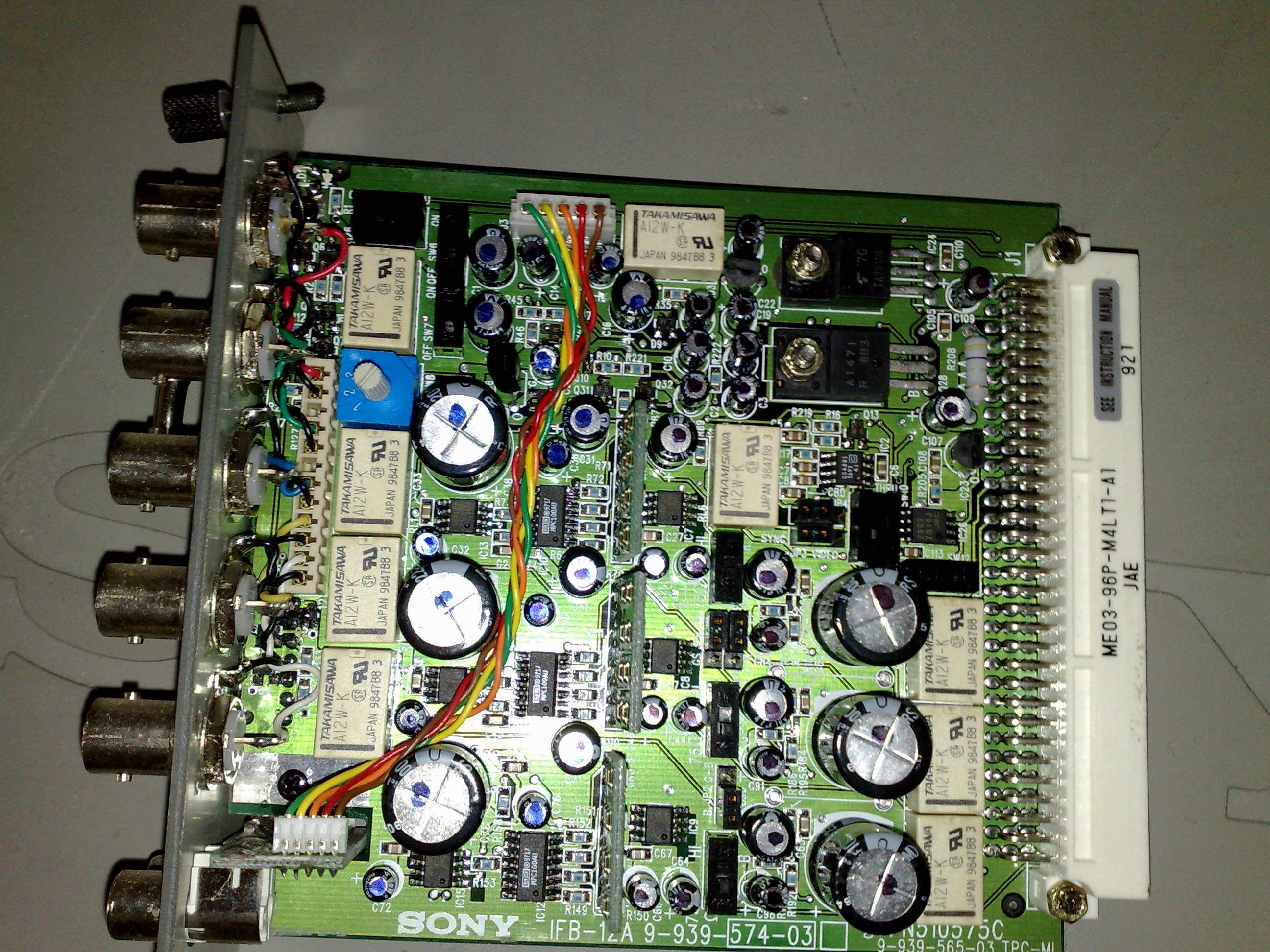

Posted: Sun Mar 08, 2009 12:38 am    Post subject:
Heres Pics of Inputs A & B
Input B card llooks to be named IF 12A
Cant make out INPUT A Card
FIRST attachment pic Is input B IF 12A
 Filename:  IF 12A INPUTB.jpg
 Filesize:  496.28 KB
 Downloaded:  428 Time(s)

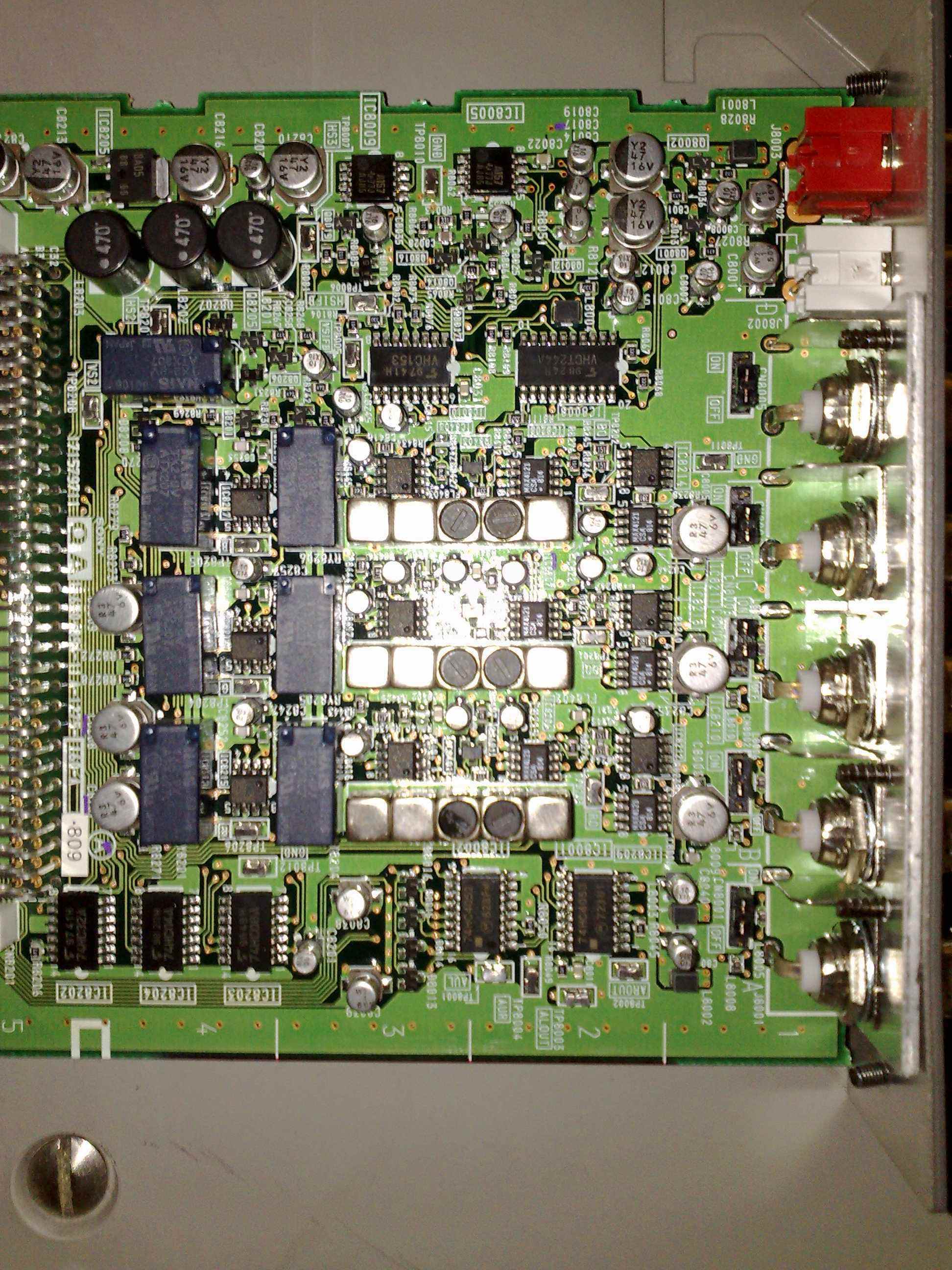

...and PIC attachment of INPUT A...which I cant make out what umber model it is..?!
 Filename:  INPUTA not sure.jpg
 Filesize:  492.51 KB
 Downloaded:  516 Time(s)
Posted: Sun Mar 08, 2009 3:18 am    Post subject:
Give us a front jack's shot of the IFB 12a card will you please?
boingo
Joined: 01 Mar 2009
Posts: 60
Posted: Sun Mar 08, 2009 4:29 am    Post subject:
Hi AnalogRocks
Yes the front jack of the IF12a (Input Card A) view can be seen in the first post here..
http://www.curtpalme.com/forum/download.php?id=7831&sid=f6a34fd36737e7e8669a5ca58c047a47
Thx
Posted: Sun Mar 08, 2009 5:05 am    Post subject:
Yeah, that's an IFB-12 - Nice IFB card for Sony projectors that was pretty common in the D50/G70/G90 period. I've seen the cards used in other Sony projectors too, including a few digital projectors, and some switchers.
Not sure about the other card, but chances are if it has the same physical interface, it might also work in a newer Sony CRT or switcher.
That what you wanted to know?

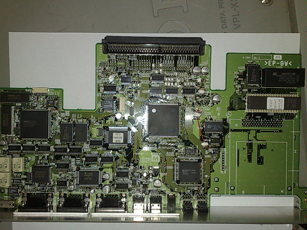

Attached : PIC of Bottom/CPU board
 Filesize:  267.11 KB
 Viewed:  8710 Time(s)
