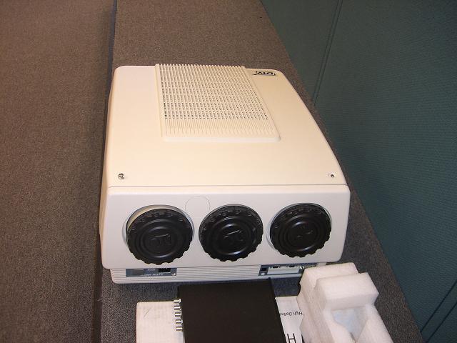

no, its doesn't look like the Barco
 Filesize:  71.04 KB
 Viewed:  6840 Time(s)
.............and may GOD bless...............
Posted: Mon Feb 01, 2010 4:39 pm    Post subject:
He's got the model wrong then..Smile
Runco DTV-863/873/940/943/947* Barco 70x
That could be any of the PG series. For $100, grab it regardless. Smile

Posted: Tue Feb 02, 2010 10:34 pm    Post subject:
curt (or others),
with the DTV badge in the photo wouldn't it have to be a DTV 930 or 933 (6PG xtra)? The other runco models that are based on NEC 6PG, NEC 6PG+ or NEC 6PG xtra are the runco IDP models like my IDP 900A, at least according to the runco MODEL CROSS REFERENCE on this site.
Sound right?
