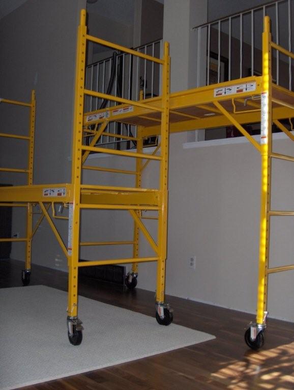

The cardboard box was the best part. The box was full of packing foam so the projector squished the top about 2" making a nice cradle for itself. Once I had the projector mounted to the shelf, I removed the boards (you can see them sitting in the saw horse legs) and took my jungle gym apart. When I moved the projector I actually used scaffloding. I moved the lower one in front of the high one and put the projector on tier 1, stood on tier one, lifted projector to tier 2 (on a couch cushion), slid it into place, removed cushion and viola. Much easier than my first attempt, but not as cool. Wink

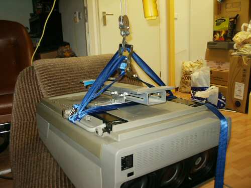

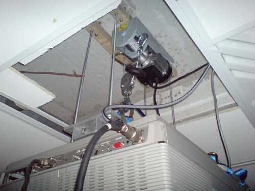

This is how I started Laughing
My 1292 did go up the same way, push the button and release it just in time Mr. Green
André
Now, this is funny!... Razz
Look at this:
http://www.kbconsulting.com/ampro.html
It looks almost like we worked together! Even color of the straps...
It worked for e perfectly too, and even though the sliding door is protruding from the ceiling (not enough depth), it's practically invisible. The lift IS bit too fast though, and as you mentioned, you have to be careful operating it,
