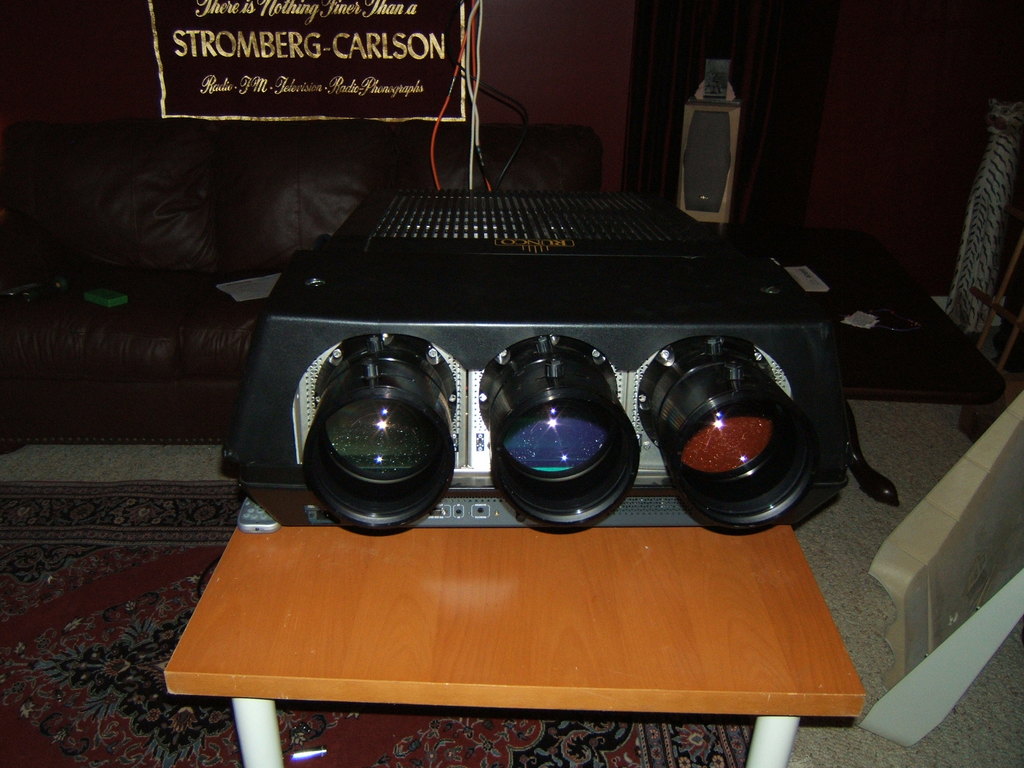

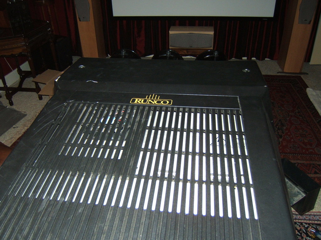

Gary M.
Posted: Wed Feb 18, 2009 12:00 am    Post subject:
my 1101 has a much bigger solid gold Runco emblem in the middle of the case versus yours jk
my case is in the junk bin, I remove them for hushboxing Smile
-Gary

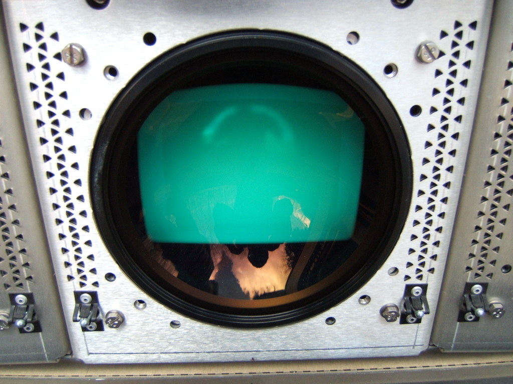

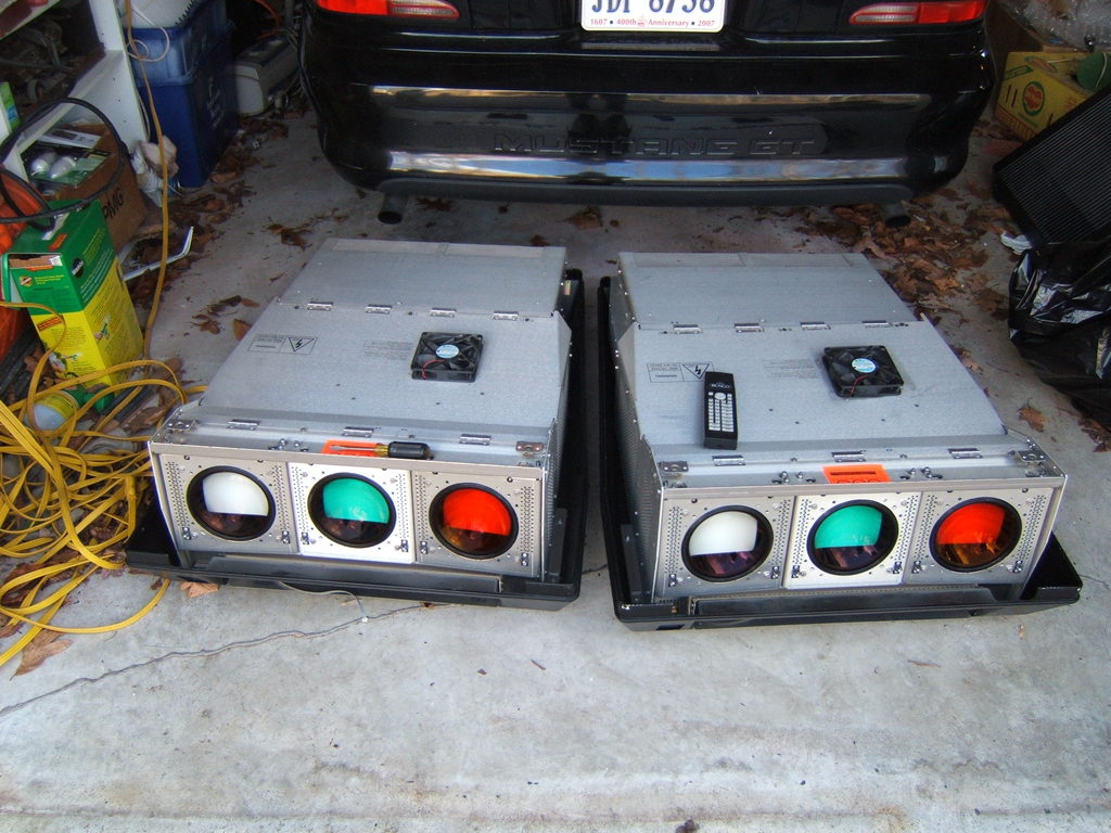

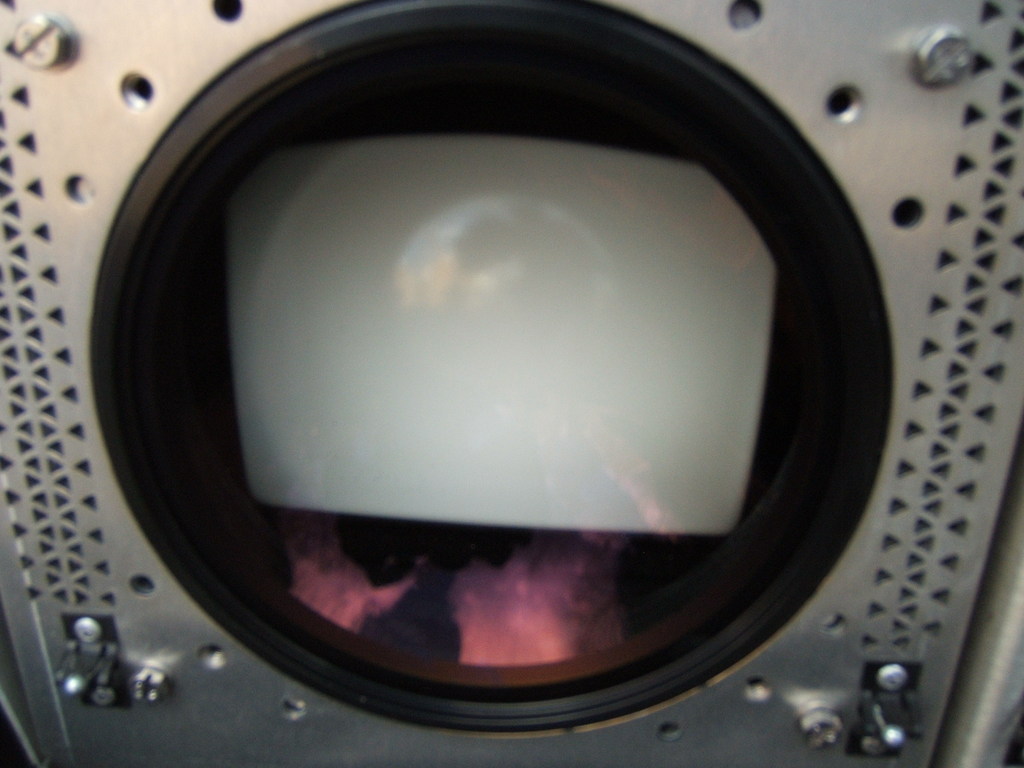

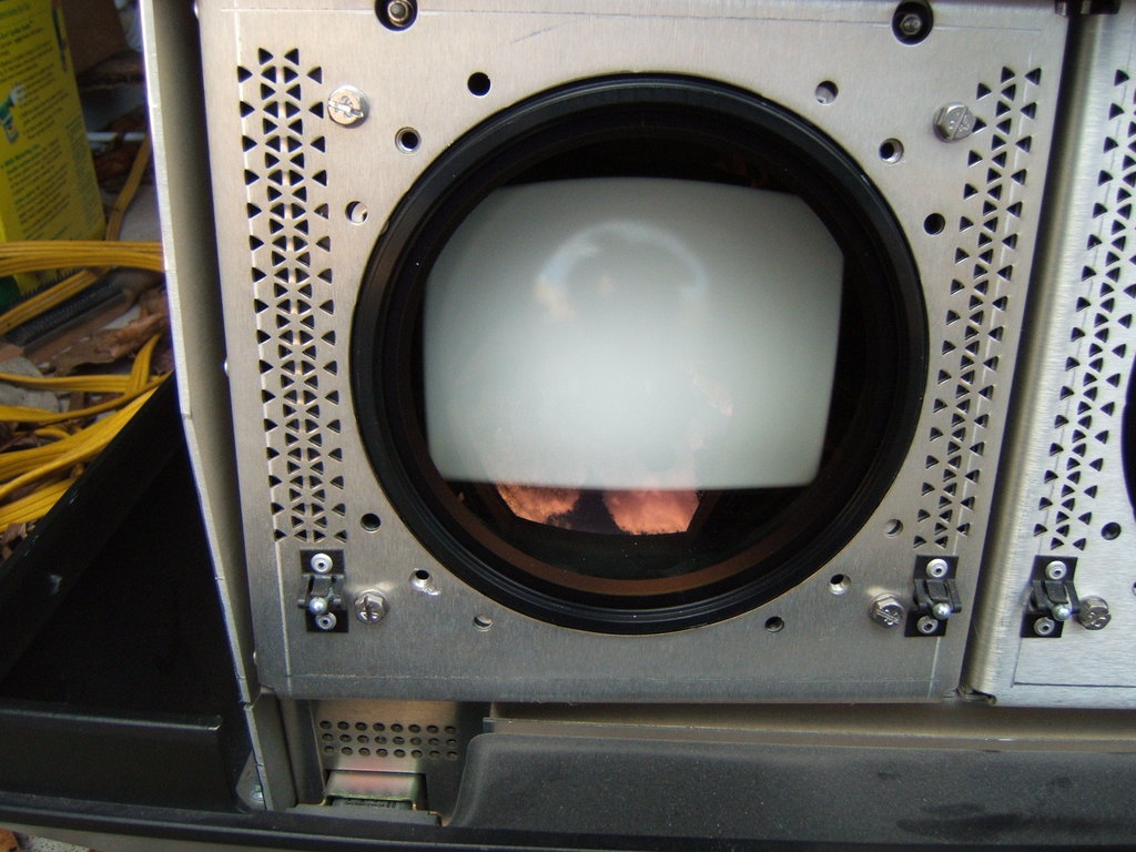

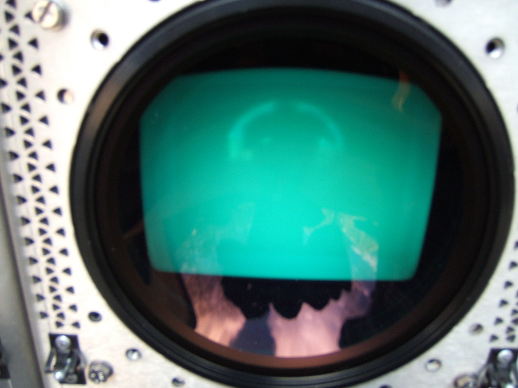

Actually I forgot I already had some photos on my machine here. They are not the best and the one of the case makes it look worse than it is in person. But here are some photos.
Blue tube in twin 2
 Filesize:  124.91 KB
 Viewed:  9648 Time(s)
Front of twin 1
 Filesize:  152.45 KB
 Viewed:  9650 Time(s)
Top of case of twin 1
 Filesize:  176.8 KB
Green tube in twin 2
 Filesize:  137.56 KB
Green tube in twin 1
 Filesize:  180.78 KB
Blue tube in twin 1
 Filesize:  170.26 KB
Naked twins....
 Filesize:  174.01 KB

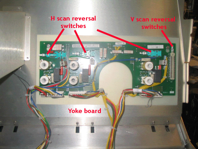

I have a spare yoke board that looks like that one. Mine says #762121 Is there any advantage to putting this board in my PJ?
Posted: Wed Feb 18, 2009 5:08 am    Post subject:
The deflection switching board # R762457 is used in both the 1208s and 1209s graphics series.
Given the significant differences that appear to be on the deflection side of things compared to the Graphics, I don't think swapping any particular board will make any difference in performance. And unless you need beyond 1080p 60Hz I am not sure they is much point to upgrading all the bits necessary to make a difference. Madhatter has done Data to Graphics upgrades and it is fairly extensive.

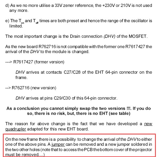

In fact I seek a modify (or trick) if exist for to use older HV components (eht/splitter/quadrupler) in newest motherboard/frame.
In that document is written there that it is impossible.
However there's this note:
 Filesize:  70.91 KB
 Viewed:  9514 Time(s)
