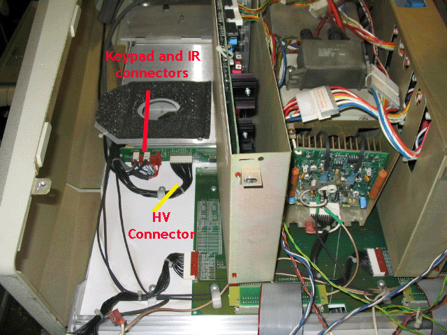

it neither, tis the bunch of black wires that plug into the VNB and the mother board. it might be easier to unplug the ones on the mother board.
its the black bunch of cables with the white connectors that goes to the VNB and the mother board red connectors in this pic
On the green tube they are connected, in the place where the red tube should be you see it connected to the mother board but the other end goes out of the picture.
_________________ Don't blame your underwear for your crooked ass~ unknown Greek philosopher
