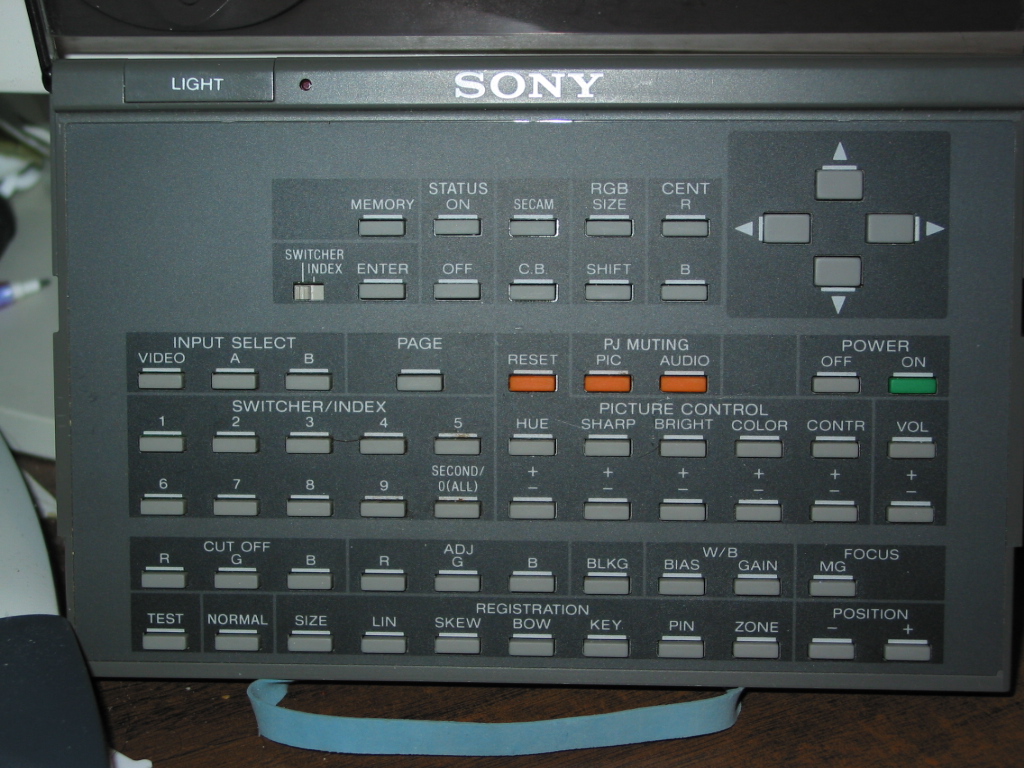

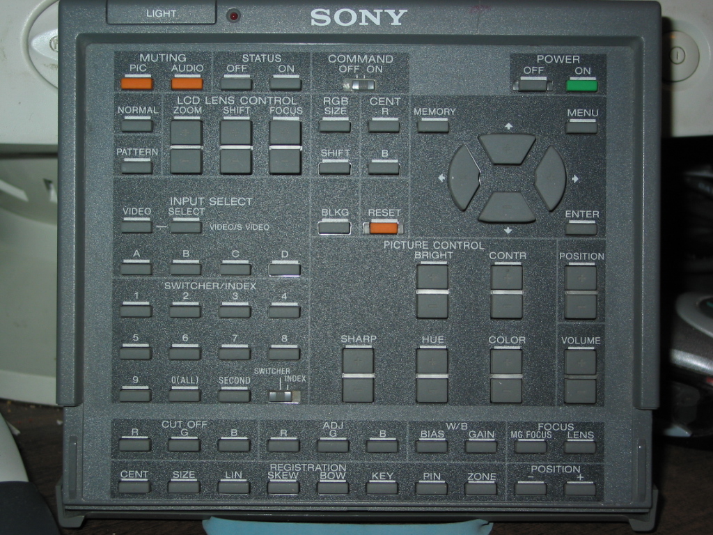

I got the remote plugged in, only to find it has no enter key, and considering I'm using the tether for the chassis control, the enter key on the box is useless, meaning I can't enter service control mode. And aparently you can't enter service control mode from the keys on the machine, unless there's a problem with mine.
correct me if im wrong, but service control mode is (enter, >, enter, >, up, > down, >, enter)?

Posted: Fri Jan 30, 2009 8:05 am    Post subject:
Let me put the two remotes side by each and have a look.
Posted: Fri Jan 30, 2009 8:09 am    Post subject:
Right under the memory key on mine is the ENTER key
Posted: Fri Jan 30, 2009 8:15 am    Post subject:
Here's the two just for comparison's sake:
 Filesize:  375.31 KB
 Viewed:  4688 Time(s)
 Filesize:  478.25 KB
 Viewed:  4690 Time(s)

Yes, to enter programming mode it is "enter, enter, up, down, enter". Let me take a look in the attic to see if my spare came with a remote that I may be able to let go. If you have a pronto I may have the ccf file for the D50 that I could send you.
