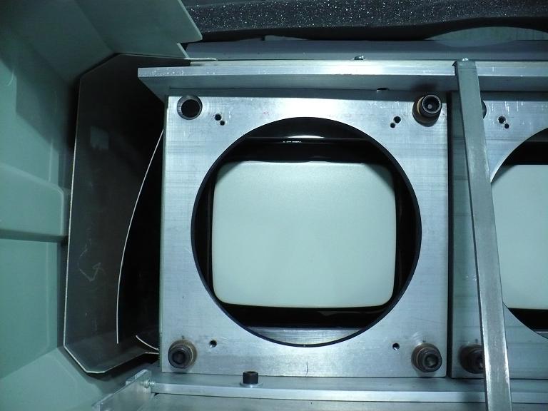

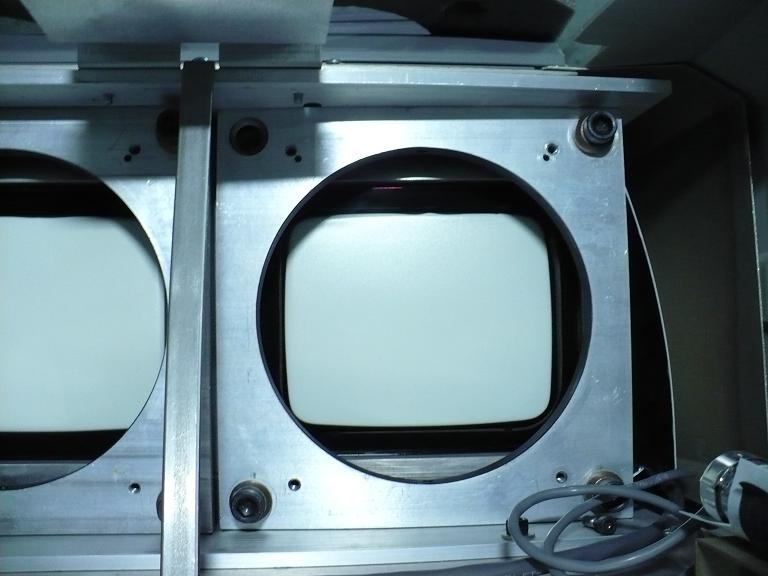

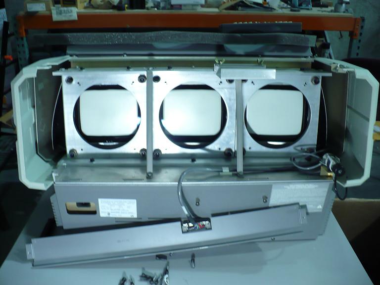

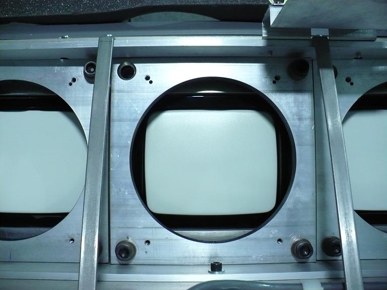

I removed the lenses this morning and took some pictures. These look pretty pristine to me, how about to the rest of you?
Red
 Filesize:  60 KB
 Viewed:  7199 Time(s)
Green
 Filesize:  66.06 KB
Blue
 Filesize:  65.23 KB
 Viewed:  7198 Time(s)
RGB
 Filesize:  65.97 KB
There are 10 kinds of people in the world, those who get binary and those who don't.
Posted: Wed Feb 18, 2009 5:23 pm    Post subject:
Good deal! You should get lots of life out of those tubes providing the projector hasn't been on in standby for many thousands of hours.
Posted: Wed Feb 18, 2009 7:17 pm    Post subject:
With 8500+ hours on the tubes it must have been retubed recently, id say those are 1000 hour tubes at most. Nice score again, We will all be her to help with any set up questions you have.
Posted: Wed Feb 18, 2009 10:26 pm    Post subject:
Definitely low-hour tubes. FYI, there is absolutely no wear whatsoever from what I can see... If there's any wear it all, it usually shows up in Photoshop when you crank the shadow slider and gamma... I get nothin'. They look minty to me - no wear whatsoever.
Pick up a set of color-filtered HD144's and a set of Joust's adapter plates and that'll be one hell of a nice machine!

Posted: Wed Feb 18, 2009 11:02 pm    Post subject:
I'd leave it be for at least a few months. Get use to how beautiful that picture is then try and score HD144/145s. Then you'll really appreciate how nice they are.
