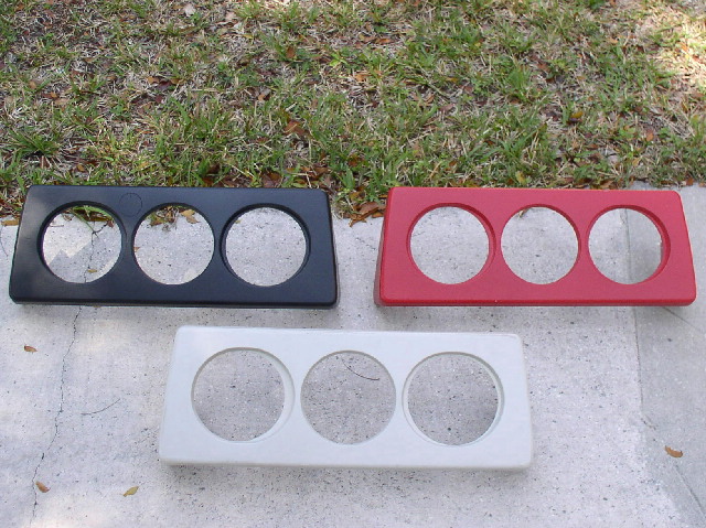

I took the plastic pieces off and painted them seperately like you did. It was pretty quick. I think the hardest piece is the front piece with the connectors, maybe 15 minutes. If I didn't paint for a living, then I would use Duplicolor.

Posted: Thu Feb 12, 2009 3:03 am    Post subject:
Spanky Ham wrote:
Here is mine with a little gloss in the mixture. Flat looked like crap. My gloss level is probably only slightly higher than yours, Case.
Hey, you made a Runco 900. I have one of those, looks just like that. Runco didn't use primer over the beige and the paint chip's way to easy.

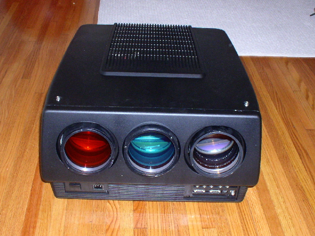

Posted: Fri Feb 13, 2009 12:09 am    Post subject: Painted my 8500's case
To paint the plastic sides of my 8500's case, I first applied 2 coats of Valspar plastic primer. Then I used Rustoleum Universal all-surface flat black paint to paint the sides and the back piece.
Here are pieces ready for paint:
Here are the finished pieces. I applied 5 light coats of black paint to all 3 pieces.
It was really hard to get a good picture in the theater since the lighting is not set up to illuminate the projector. This was taken with the flash. You'll also notice I made some felt covers for the glass doors of my component cabinet as a test to block out all lights and reflections, and it's awesome. The theater now goes pitch black during black scenes.
