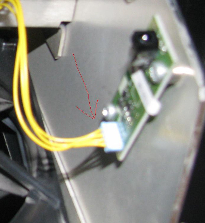

There is only one lead that looks like it can be disconnected (pic attached)the other lead goes to the motherboard.
This lead in the pic wont budge,I mean it feels like the really really stuck.

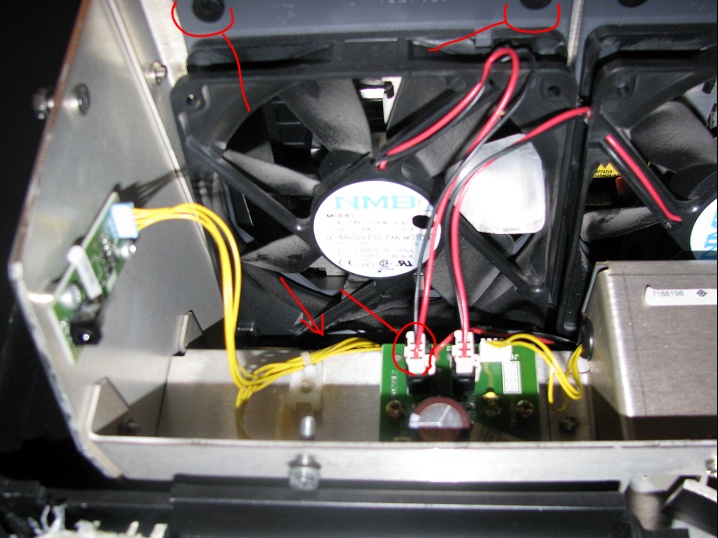

Dave, you need to disconnect the other end that has a plug & socket down on the motherboard under the fan. You'll have to remove the fan by popping the two plastic rivets out, unplugging the fan power connector, and lifting the fan straight up.
Mark

Posted: Sun Dec 21, 2008 3:48 am    Post subject:
Actually, since you're ceiling mounted the fan will likely fall out once you pop the two plastic rivets....
