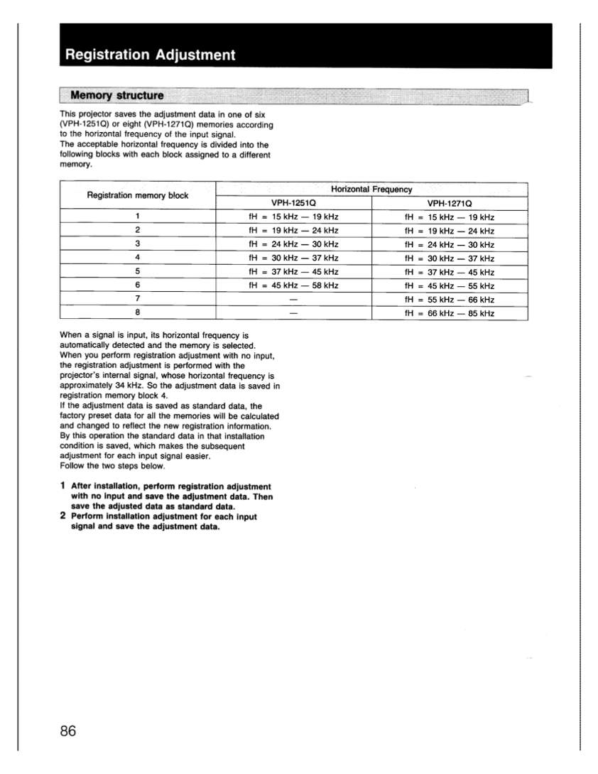

The 1272 assigns and recalls geometry settings based on the input signals horizontal frequency (fH). There are 8 blocks on the 1271 and 1272.
So, for instance, you can set up the geometry controls to display a 1280x720 input correctly on your 96x54. Those settings would be stored in block 5 or 6 (I can't remember which - 720p is right on the edge). Then, you could set up another resolution at 480p for 4x3 material at 72x54, for instance. Those settings would be stored in block 4.
Because of how the memory registration blocks work on the 12xx, what you can't do is have switch between 4x3 and 16x9 at one resolution - say 480p. For that, you'd need to do something at the source... which most HTPC-based software will do just fine without changing resolutions.
I never had to worry about aspect-ratio control because all my sources (DirecTV, PS3 (BD), and HD DVD) all displayed everything at the proper aspect ratio, and all at 1080i - which is what I always ran on my 1271. Your HTPC-based player should do the same.
FYI, the 12xx's are very well suited for 1080i for film-source material. 1080i looks awesome - high horizontal resolution, and no scan lines because the lenses on the 12xx's just aren't sharp enough to reveal it. 1080i on a 12xx is very film-like.
I wouldn't run 720p on the 12xx, unless I really had to look at a PC desktop and read icon names. I had a monitor mirroring the signal for that.
PS - The block assignment table is on page 86 of the 1251/1271 install manual.

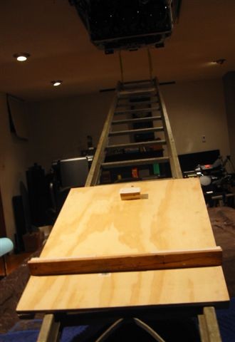

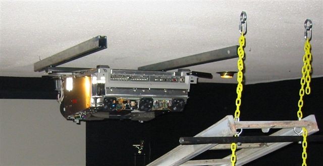

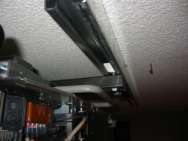

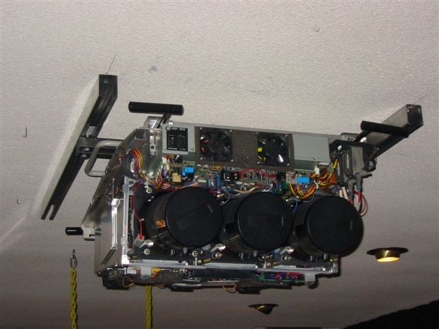

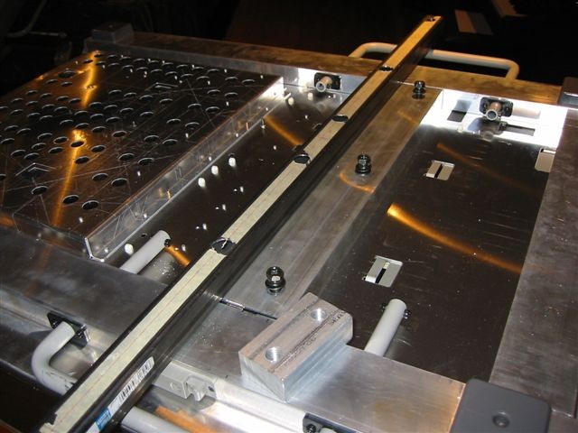

Pic’s of projector mounting system consisting of two rails, two mounting bars, two slide blocks and mounting hardware. This mounting system keeps the projector parallel and close to the ceiling. The top of the screen (4:3) ends up near the ceiling. This is ideal for my application. The rails are intended to be used to mound a hush box.
As you can see, the rails allow for sliding the projector in the z axis (nearer or further from the screen). The length of the rails determines the amount you can adjust the distance to the screen. The rails are mounted, 34 inches apart, to the studs with 5/16 lag bolts at 16” intervals. The distance of the rails from the screen is such that the projector is positioned 1/3 back from the leading edge of the rails for the calculated working distance. This allows for significant adjustments for any tolerance issues. You can purchase the rails at Tractor Supply.
The mounting bars simply attach to the projector with the Sony recommended metric bolts. The mounting bars are standard 1 1/4” square tubing purchased at Tractor Supply.
The slide blocks simply attach to the mounting bars with ½ inch bolts. The slide blocks are made from scrap aluminum stock. You could use a nut and washer in place of the blocks however the washer should be hardened to prevent bending under load.
To simplify positioning the projector to the mounting rails a ladder was used. One end suspended from the ceiling and the other end resting on the table with the projector. This gives you a ramp to slide the projector up into place. It’s much easer sliding then lifting. When the projector is at the top, and all the weight at the suspended side, you simply lift the other end of the ladder making it parallel with the ceiling. At this point the slide blocks should be in front of the rails. All you have to do is slide the projector forward while inserting the slide blocks into the rails. Done!
