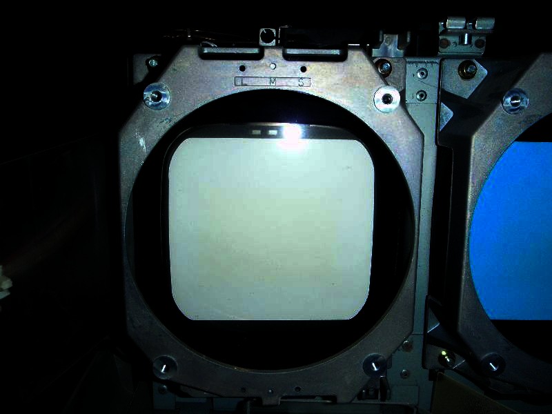

I got a bit daring today though. Now that I have the stuff off I have noticed there is a lot of built up dust in there. I figure I could use compressed air to blow most of it out and have a vaccum on the otherside to remove a lot of it.
Now that I have it apart what should I do besides clean up the lenses? I kinda would like to do everything that I need to do to it before hoisting it up
That reminds me also, in the un-oficial manual it states that I should tape a cross hair over each tube. What is this for? Is it so I can align the guns to maximize the phosphor?
There really isn't any tube wear that I can see.
Posted: Sat Dec 13, 2008 6:55 am    Post subject:
There is a little wear on that tube. Looks like it was setup too far back or on too small of a screen.
However that being said you may not notice a thing once you have it all set up.
See the yellow area in the adjusted picture below:
