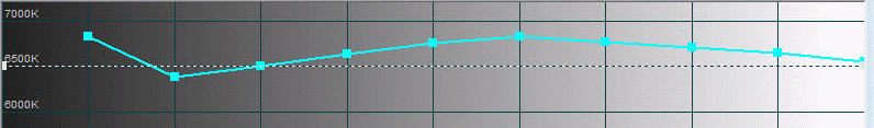

Mine is defocused enough that it's noticeable (and often annoying, to me anyway) on sharp edges in actual video content, not just titles & crosshatch patterns. And I still have some blue hump -- see below.
Gary, the whole reason for defocusing blue is that the blue phosphor saturates long before the R/G phosphors. The saturation point isn't a hard cutoff, but a change in the slope of the in-vs.-out response curve. Once it saturates, increasing the beam current will still increase the brightness, but a LOT less. **IF** your scaler can boost the high end "enough" to compensate, then maybe that would work, and apparently it did for you. I assume you'd also have to boost the gain on the blue tube so you were able to drive it harder than the R/G, but that should happen naturally as a result of color calibration.
(For anyone who's wondering: defocusing spreads the electrons out over a larger area, so you get more photons out before hitting saturation. Which is also why people are talking about getting "more light" when they defocus. It's easy to tell when you've got the blue perfectly focused: that's when the blue output is the dimmest.)
Unfortunately a scaler is NOT in the budget for me, so I'll have to put up with blue fur.
