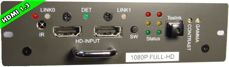

If you connected to the hdmi 1 port then that be it or its the one that is active and ready to accept input, the green lets you know when a signal is transmitting(at least its that on the old one)
deewaan1
Joined: 06 Apr 2008
Posts: 68
Posted: Fri Jan 30, 2009 10:32 pm    Post subject:
Ya that was it. I guess I was looking at the back when I had my PS3 off. It goes green when th esignal is transmitting. Thanks!

Hi moome,
Can you tell me what level of testing you did with the VIM-FULHD and custom 1080p timings? I need to run a non-standard 1080p timing (e.g. H-Front: 86, H-Sync: 96, H-Shift: 336, V-Front: 1, V-Sync: 5, V-Back: 38) and I want to make sure this will work OK with the VIM card. I'm having trouble using this setting with HDFury2 and I need an alternative.

I need the special timing because Marquees do not handle standard 1080p timings properly. One of two problems occur:
1. In Long Retrace, a significant chunk of the left side of the image is cut off.
2. In Short Retrace, you get jail-bar ringing on the left side of the screen.
The solution to both options is to adjust the timing to add more porch pixels.

I just wanted to say I have now the card installed. The picture is better than what I had before, but there seems to be a problem. When I turn off the projector from the projector's control and when I try to turn it back on there is no image, I can't even see the projectors on-screen menu system. I have found that if I turn off the source (an apple TV) and disconnect the hdmi cable from your card, when I turn on the projector the image comes back.
There is also a problem when I set the AppleTV to 1080p HD, there are jaggies in the image. the image is perfect when i set it to 1080i HD. But this might be a problem with my appleTV and not the card.
Do you have any ideas on these problems?

for the question 1, when you turn off the projector and keep hdmi source turned on, does any led light up on the card?
