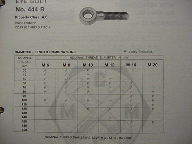

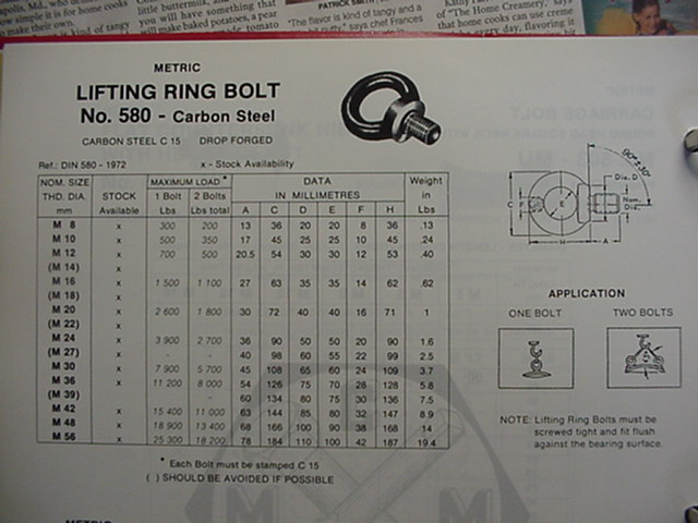

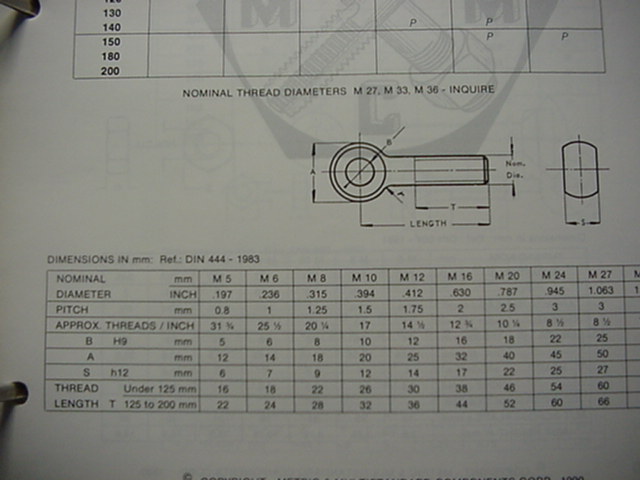

Here are some pictures of the eyebolts listed in the catalog that I have. As you can see, the one style has a very small ring. It might be a problem to get a piece of round stock that is strong enough---stiff enough to hang the projector on. The style with the larger ring might not have a long enough shank to give some drop distance. There are probably more "normal" eyebolts available, but this is all that I have listings for. A Google search might find something better or there are a number of ways something could be fabricated. Anyway, the phone for Metric and Multistandard is: (800) 431-2792

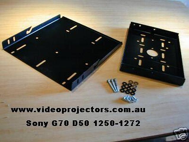

Posted: Wed Nov 05, 2008 1:48 am    Post subject: g 70 bracket
Hi there is one on eBay may save you the hassle Very Happy
http://cgi.ebay.com.au/ws/eBayISAPI.dll?ViewItem&ssPageName=STRK:MESELX:IT&item=320314111536

I used that same factory braacket on my D-50. It made the whole process of installing and tilting very simple. If you are going to bolt the unistrut to the ceiling why not just bolt the factory bracket to the ceiling instead.

One problem I have is that where I am going to mount the projector, there is a 12 inch beam going across the ceiling. I plan on mounting it behind this beam, thus the pj lenses need to be at least 12" from the ceiling. It looks like the factory mount will be less than that.
Is the only option for the factory mount to be flush with the ceiling?

Nope, see that hole in the middle of the top mount, that's for a pipe extension called the PSS-10
