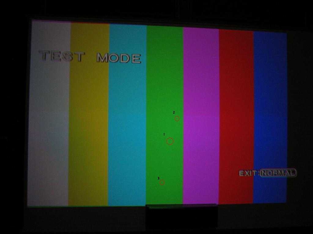

G90 Spot burns on new Tubular tube? Seen antying like this?

It never looked like a spot burn in the first place. Then you have all the time and shipping costs trying to prove it........ Rolling Eyes
 Filesize:  37.71 KB
 Viewed:  8149 Time(s)

Posted: Sun Nov 16, 2008 4:50 pm    Post subject:
well no one here or at AVS thought it looked like spot burn. However Mr. Caligraph was convinced even though he admitted to not being and expert on the subject. I think the real underlying problem here, I mean the root cause of this whole situation, is poor QC on the production line. I'm pretty sure this tube would have never left the original production line at Pannasonic Japan but it was obviously good enough for Mikado China. Sad
I can say that all the new tubes (not re-built) I've gotten from VDC florida were always excellent. Not sure of they were Japanese build or VDC since VDC is making new tubes now. It's just a shame their 9" tubes are so ridiculously expensive and their policy towards us with bellows and c-element sales has been so hostile.

Posted: Sun Nov 16, 2008 8:39 pm    Post subject:
From what I understand, VDC already had a Panasonic/MEC tube rebuilding setup, so they bought all the inventory from Panasonic, but not the production line. This Chinese (?) company bought the production line, and are now having phosphor issues.
The first few tubes I bought from Tubular had 'orignal' Panasonic stickers on them, so I'm guessing that Tubular had those in stock before the production switch. I had no phosphor issues with those. One had bad focusing, Tubular replaced it right away.
A second one had focus issues after 200 hours, Tubular replaced that one as well, and the new one came in with that 'new' brand on it.
I didn't care, but I'm curious how it will stand up.
Seems as with the issues that VDC has had in the past, a smooth phosphor coating is a bitch to get right on the inside of the tube. Ditto for a 'clean' assembly of gun to neck, and lack of impurities in the tube vacuum itself.
Again, it would be good for Tubular to comment, I don't want to be posting inaccuracies...

Posted: Fri Nov 28, 2008 7:45 pm    Post subject:
Two weeks ago after Charlie had taken a look at the tube I called Tubular and left a message saying that I wanted to talk to them about it.
Apparently that was out of the question.
Here's the text message I received as the response:
Fri, Nov 14, 1:11pm
From: 407-XXX-XXXX
Got your voicemail
Have no wish to waste further time wuith u
Email whatever the report says from charlie and I will deal with it
Do not call again despite what you think the owners of q4 ae not at your beck and call
Forward the report and we will deal with it directly and appropriately
Regards
Here is the email thread that transpired after that.
From: Kris
Subject: Re: crt
To: Tubular
Date: Fri, 21 Nov 2008 15:49:48 -0800 (PST)
You win.
Charlie is not comfortable putting anything in writing for you and I will
not press the issue with him.
I dont believe I did anything that would have burned the tube to produce
the spots, or exposed it to any abuse that could have produced a 16x9 wear
pattern in the 45min I displayed video.
The fact that both exist indicate a severe manufacturing and quality control
problem.
No, I am not going to accuse you of selling a used tube as new (in spite of
the fact that the first tube you sent was clearly previously mounted and
scratched on the face of the glass; I will trust that it was 'electronically
new').
It seems wrong to me for you to advertise a Panasonic tube and sell something
else. You can explain all you want about who makes them and where they come
from, and even insist that they are superior to a Panasonic tube. But at
the end of the day you advertise one thing and deliver another.
I did not post to the forums anything about the wear since I expect people
would jump all over that. Charlie, Curt and Terry have talked about the
problems VDC had with getting the process down for coating the tubes and that
along the way they had tubes that needed to be 'aged' to prevent premature
wear.
Suspend your disbelief for a moment and consider that perhaps the spots are
defects that the wear pattern after an extremely short period of use is also
indicative a coating defect.
Keep an eye out for these problems with the clients you continue to serve.
Kris

>> Terry removed the mounting hardware and sent it to Charlie at VDC.
>> I spoke to Charlie yesterday.
>> His opinion is that the pinholes are defects in the phosphor that were
>> present in manufacturing when the tube was aluminized.
>> He says that when magnified he can clearly see reflective silver behind
>> the holes.
>> He tells me that if they were burns that aluminum would have been
>> destroyed from the other side of the tube face.
>> He does not believe pinhole spots like these could have been produced by
>> an end user burning the tube.
>> Also of note is that both Terry and Charlie report the face of the tube
>> appears to clearly have a 16x9 wear pattern.
>> This is another mystery since I had the tube in my projector for about
>> 24 hours, and only showed full frame video on it for about 45min at
>> contrast 70 after doing registration and focus to see if the spots would
>> be tolerable.
>> I would say that there is no way the tube was on for more than 10 hours
>> total and the bulk of that time was displaying the internal grid or
>> cross test patterns at contrast 50.
>> While at your facility, was the tube put in any condition that would
>> have created a wear pattern? If it was there when I had the tube, it
>> was not visible through the glycol and c-element.
>> Please advise,
>> Kris Roberts
