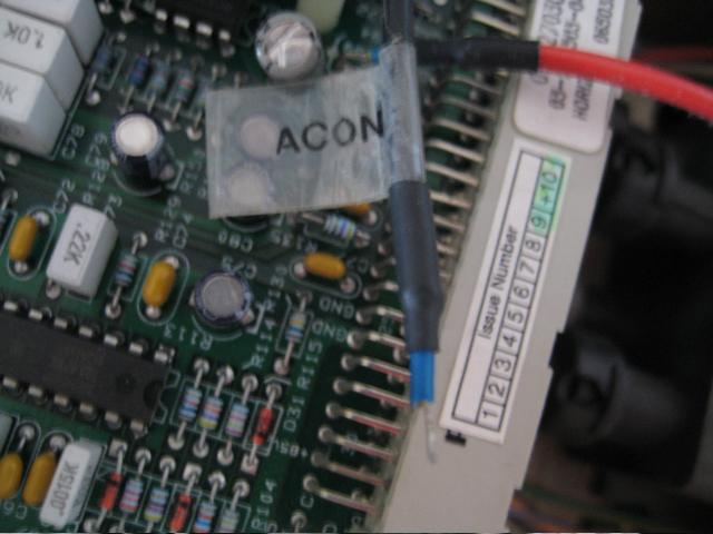

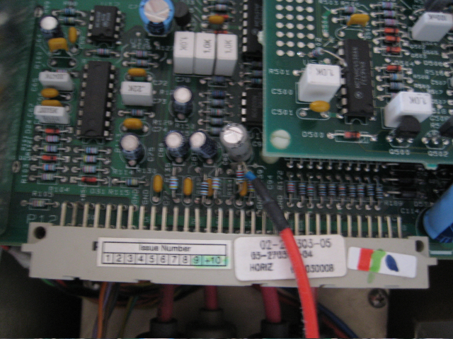

 Filesize:  452.69 KB
 Viewed:  7113 Time(s)

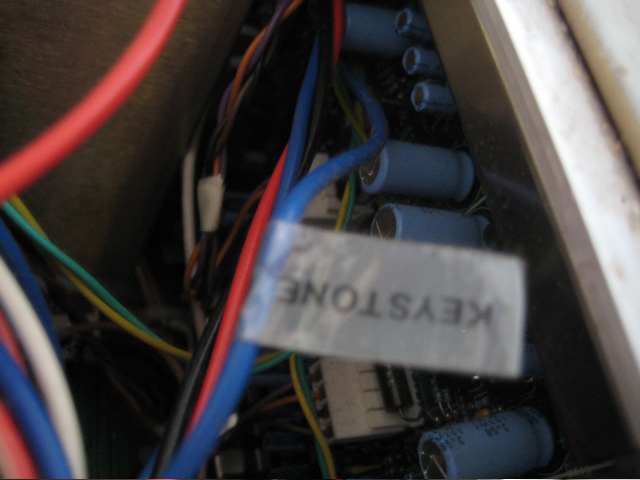

 Filesize:  372.89 KB
 Filesize:  413.87 KB
snkby
Joined: 12 May 2007
Posts: 134
Posted: Wed Oct 01, 2008 5:11 am    Post subject:
im thinking the black lead that is disconnected might also go somewhere on the backplane as i cant see anywhwere it might have been attached on the hdm.
Posted: Wed Oct 01, 2008 10:58 am    Post subject:
I would desolder the red wire and take out the acon since you don't use it and it probably isn't working with the black not connected. Also if you want so those wires are not hanging around shorting something remove the acon board above the CLM on the left bay and pull those wires out with it if they are indeed connected to it.
I bet that was causing the issues you were having.

when i first got the pj i remember disconnecting the connector at the acon module and the pj wouldnt work with the acon disconnected.
curt told me to leave it connected as removing the acon was more complicated than just physically disconnecting it and taking it out.
so isnt desoldering the red and blue just liking unplugging the connector from the acon ?
im thinking the black lead is ground as red is labeled +24.
does anyone know for certain where the black lead goes ?
the back of the pj is close to the wall and i cant open the backplane without moving the pj so i was just going to cut the blue lead instead of desoldering it from the backplane.
thanks.
