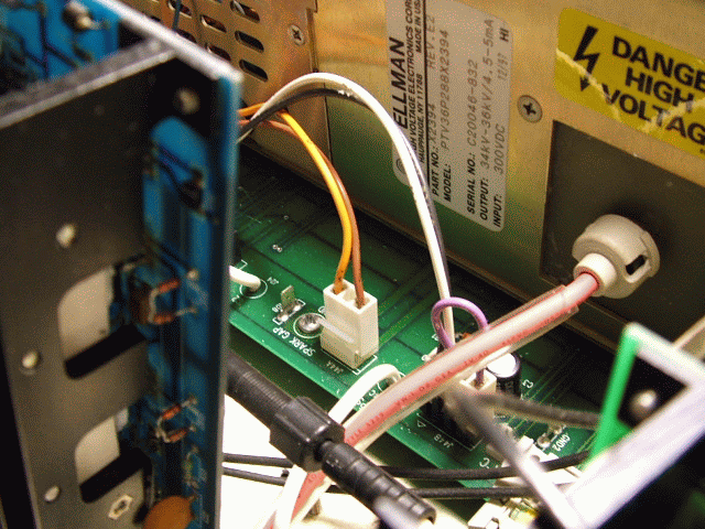

Posted: Sat Sep 13, 2008 6:29 pm    Post subject:
Greg, be careful! Playing with a projector with suspected deflection problems is dangerous to your CRTs condition. Bad things can happen. If you want to check things out then disable the High Voltage power. The tubes are safe without HV. Unplug your projector from the wall socket. Wait a few minutes for things to discharge. Unplug P44A from J44A on the mother bd. It's right in front of the Spellman. The high voltage will not come up. No picture but you can check for deflection by running 30 code. It will say HV low, G-2 low, and G-1 low. If it also says HORZ SWEEP FAIL then you do indeed have problems and you should send your boards to Curt.
Make sure you unplug the projector from the AC power and wait a few minutes before plugging in P44A.
Scott

Posted: Sat Sep 13, 2008 6:53 pm    Post subject:
Thanks for the advice. I did run a code 30 and said horizontal sweep fail and the H-supply board
had a blowen fuse. I replaced it and all the crt's worked fine and then shut down again.
I sent the boards off to Curt and he should recieve them on th 17th.
