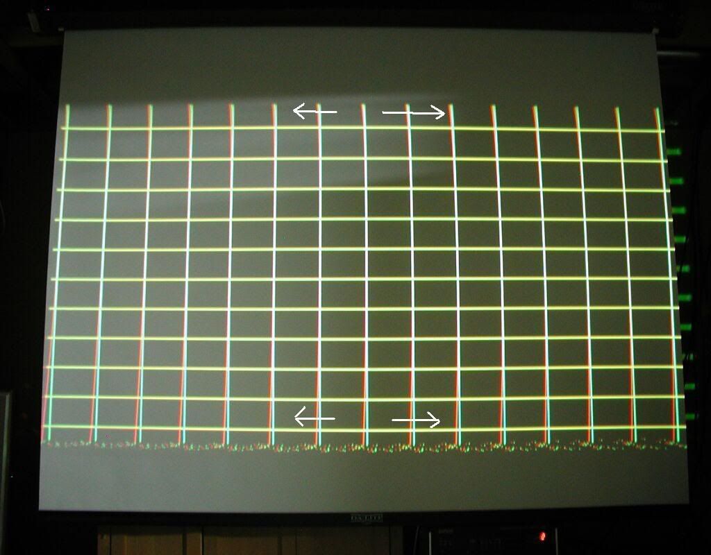

Ok, look at this image from my XG75 I threw onto the coffee table so I could have a reference to help walking you through this...
I've put arrows on the image to show you HOW Tilt/Skew affects the red line. It will move it AT BOTH TOP AND BOTTOM left/right, what you do is move it using Tilt/Skew till the amount it is OUT is EVEN on ONE side of the green line....
As you can see in the photo, the top has the red out of alignment less than the bottom but they're both on one side of the green line, that means this is very close, just shove the red using your left/right cursor buttons till it is EVENLY out of alignment on ONE side of the green line. When the amount the red is out from the green is the same at the top point, AND the bottom point, then you can use BOW, which affects BOTH top and bottom EQUALLY to pull/push it into the green line.
Your center is already aligned by doing correct raster centering/phase/toe in and touching up with STATIC, so now your outermost points in the center will end up perfectly aligned too...
PS: As a testament to doing it right...this XG75 sat on my floor all summer, today I put it back onto my coffee table, pushed it around for about 30 seconds to get it to the approximate position it had been in when I last had it setup, tweaked the STATIC a couple of clicks, and have an image that is virtually perfectly converged over the whole screen. It hasn't moved at all, even after being unused AND moved around for months....The misconvergence you see, I introduced on purpose for the purpose of the picture...
