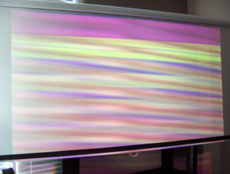

Posted: Sat Oct 11, 2008 4:16 am    Post subject:
Hey everybody,
So here's 1080p on my 9pg+...
Look familair? Confused I really want to get 1080p to work...
 Filesize:  44.04 KB
 Viewed:  6900 Time(s)
Posted: Sat Oct 11, 2008 4:20 am    Post subject:
Mr. Green wrote:
Hey everybody,
Yeah I did a tye dye kite in grade school that looked alot like that. Laughing
