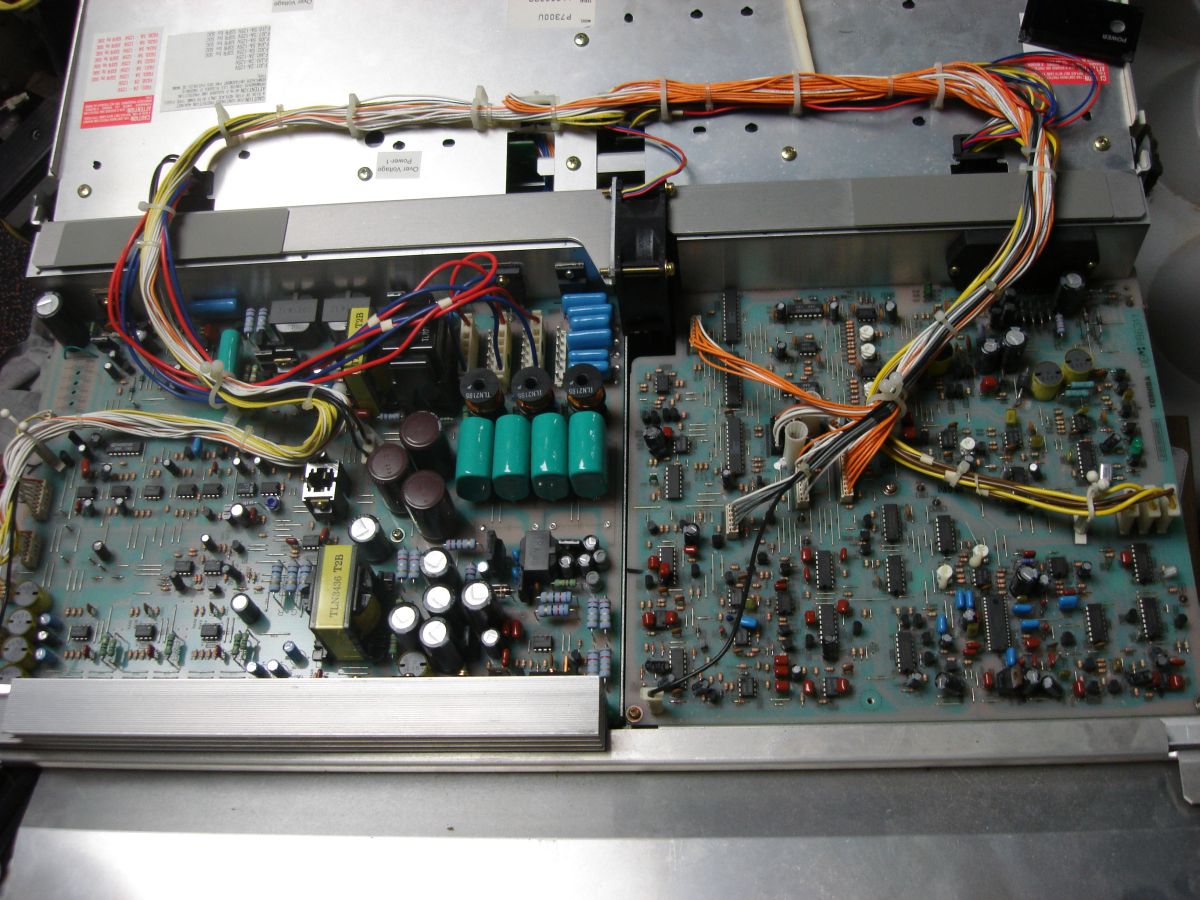

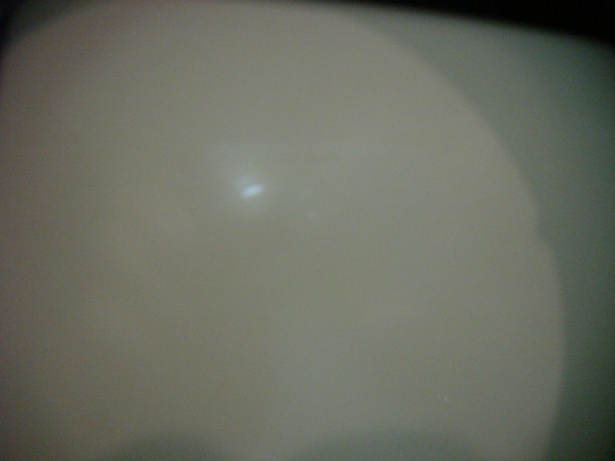

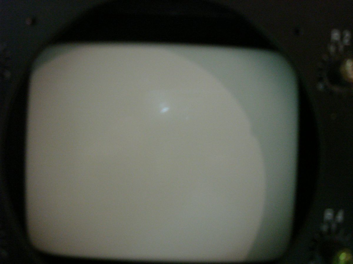

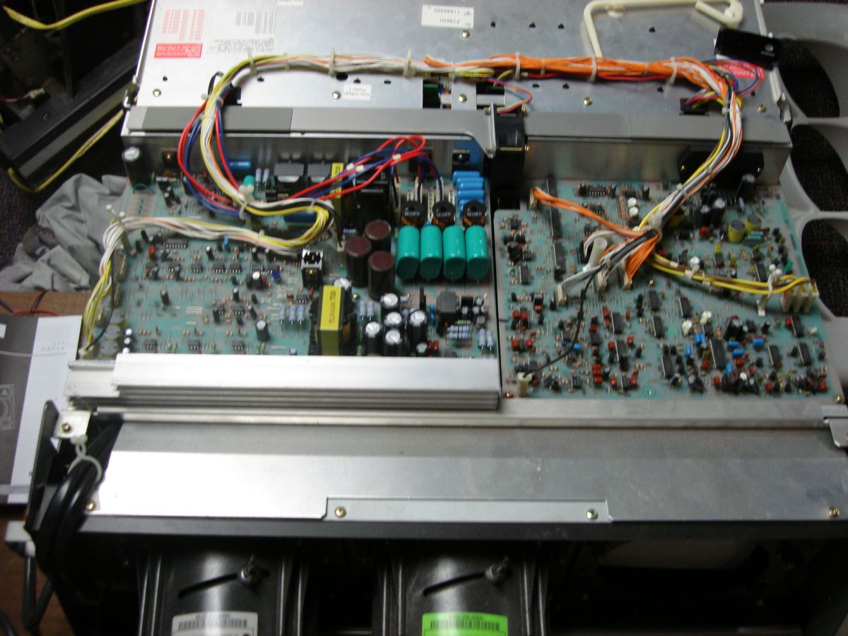

Thanks to all who have goten me this far. I do feel cleaning it first is a must. I took the cover off. Its dusty under the cover. This was nerve racking for me because i dont no that much about electronics. I took a few picks. I found out the lens's are DELTA HD 145T. Hope this info helps those trying to help me. I took more pics of the circuit board and the red tube after I removed the lens. How does it look? And I took pics of the top circuit board, theres a lot more under that
P7300U Circuit board

PIC of the red tube

PIC of the red tube

Looks nice, easy to work on modular design, and the red tube looke mint! its the green that wares fastest, so that be something to look at if its as nice as the red you have a nice long life for those tubes !

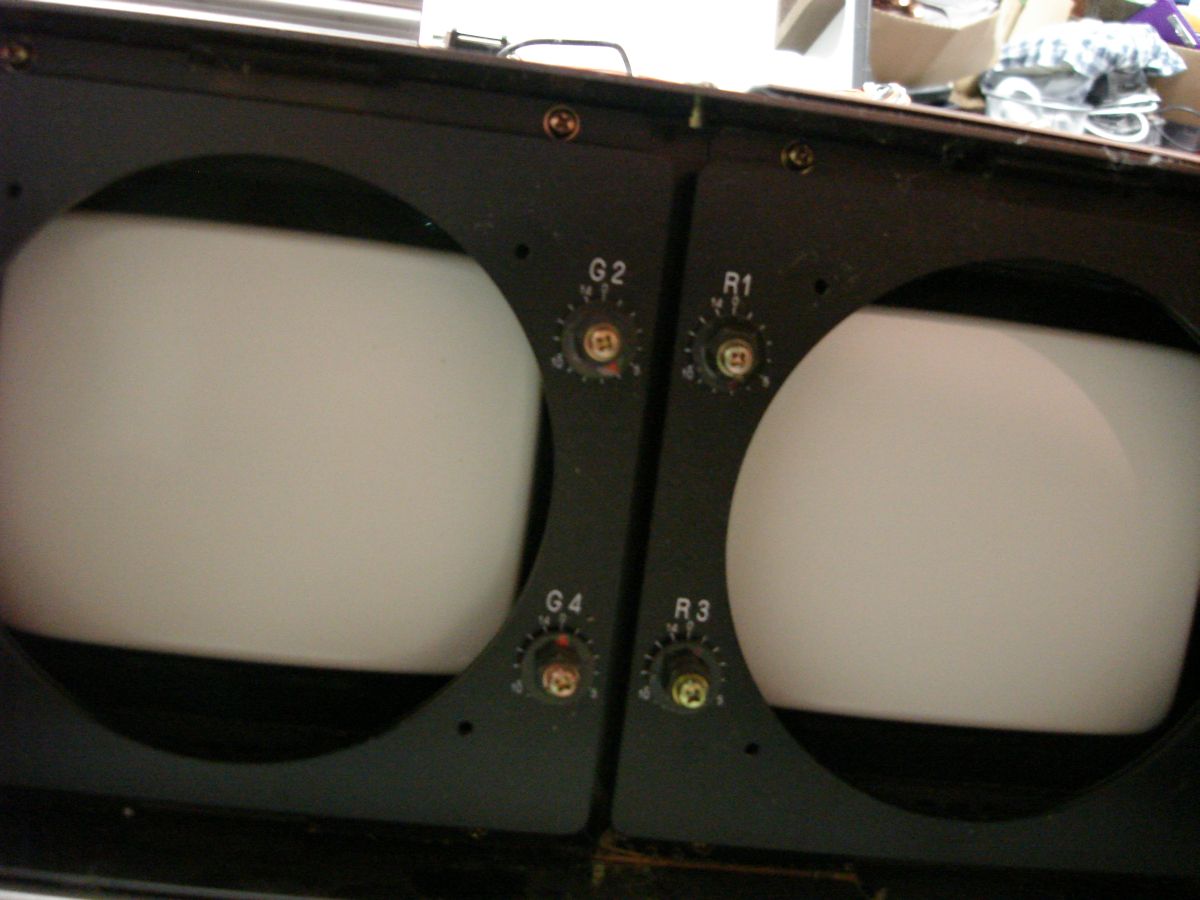

I will take the green off and send the pic. I guess i will power it up. What should i look for. Do i need to have anything hooked up i.e. dvd player?
Posted: Fri Aug 22, 2008 6:22 pm    Post subject:
Turn it on and see if a menu will come up. If its all scrambled then you need something hooked up. If you get a menu, see if there is light coming from all 3 tubes.

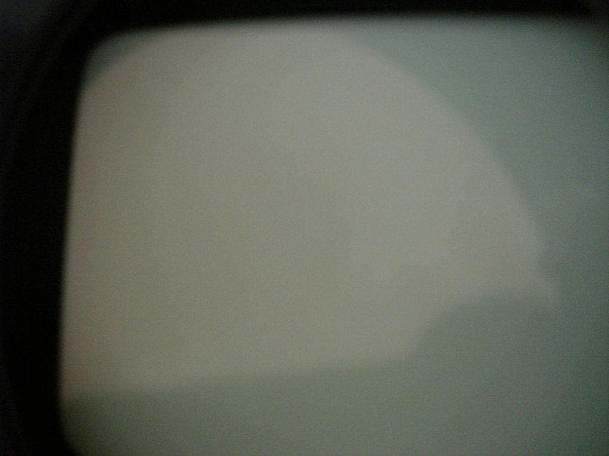

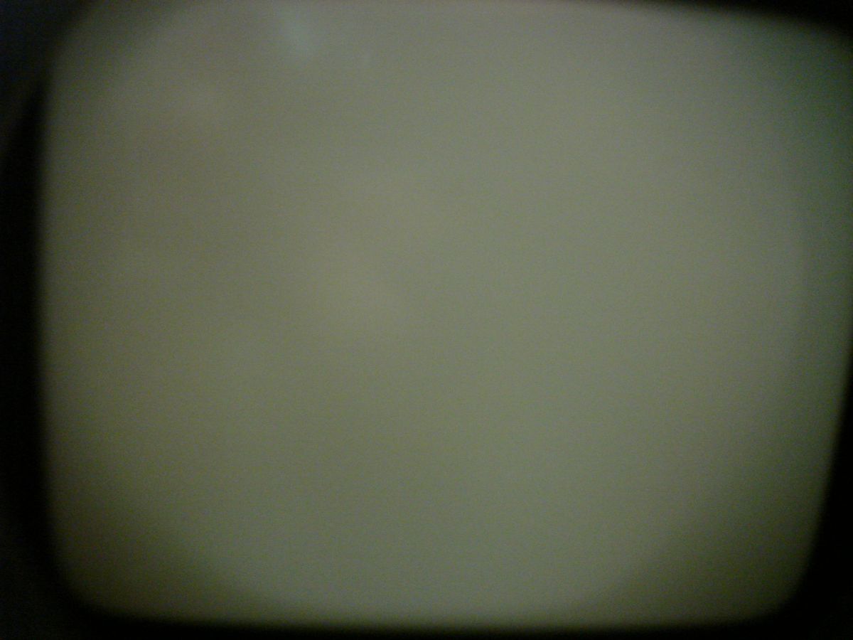

Im gettin excited here. Here r the pics of the green tube
The green tube is in the middle. The red on the right

Green Tube

Well all is good. I put the len's back on and fired up the PJ. It powered up with no problem and after about 3 sec all 3 of the tubes lit up and it said no input. I think this is good.
Posted: Fri Aug 22, 2008 7:15 pm    Post subject:
Perfect tubes fires up! your on your way !!!!! Now just get some BNC connectors to hook up a dvd player if you get an upscaling one you can output 1080i to it or 720p is what i would try first. But still do all the cleaning if you can, it will also familiarize your self with all the boards in the chasis. also i would down load and print out the service manual and read it over and over even if you dont understand a lot eventually you will, i went from not know ing anyhting to being able to do some small scale trouble shooting board level wise(with some help from guys here too of course). But to get full use of your new Projector you should look into a Video processor too for it, either a dvdo or a lumagen HDP, look on e-bay or Videogon. this will allow you to find the perfect resolution to feed your PJ to make it look its best, and they can also offer other controls for adjusting colors and gamma and much more, a HTPC or a Video processor are a must for CRT front projection.
