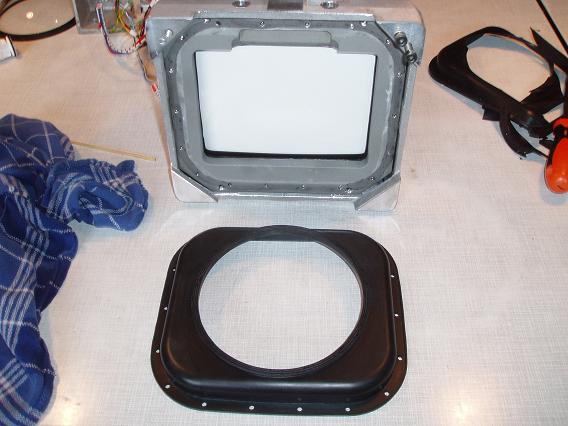

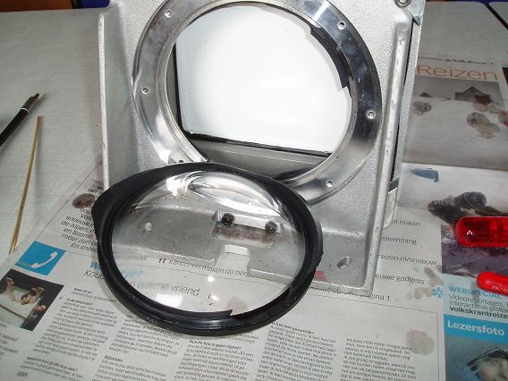

It was a busy day...
(And it's a miracle anyone could ever remove a C-element without destroying the bellow)

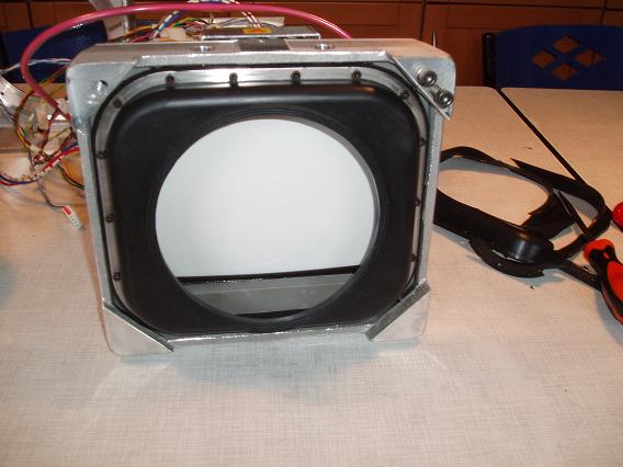

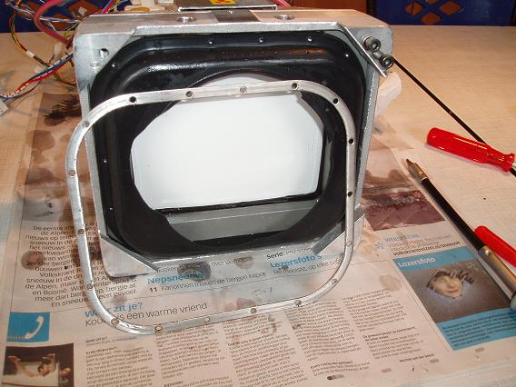

Posted: Sat Oct 04, 2008 5:12 pm    Post subject:

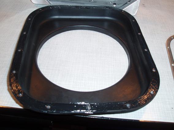

Cleaning....was quite some work

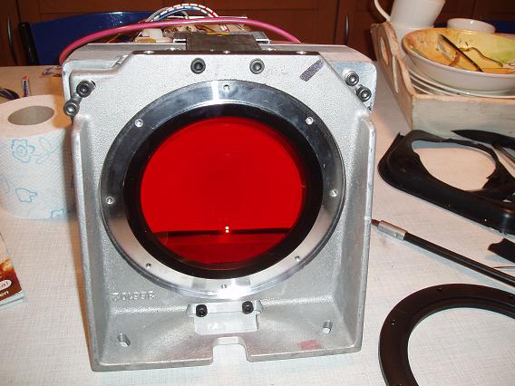

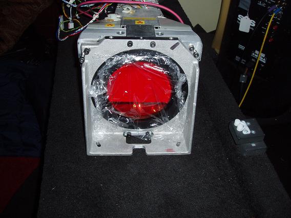

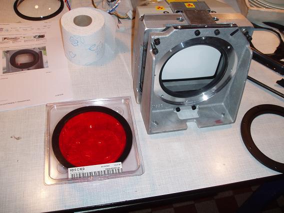

Posted: Sat Oct 04, 2008 5:14 pm    Post subject:

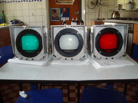

The red C....and after finishing som foil to avoid dust while drying

Posted: Sat Oct 04, 2008 5:15 pm    Post subject:

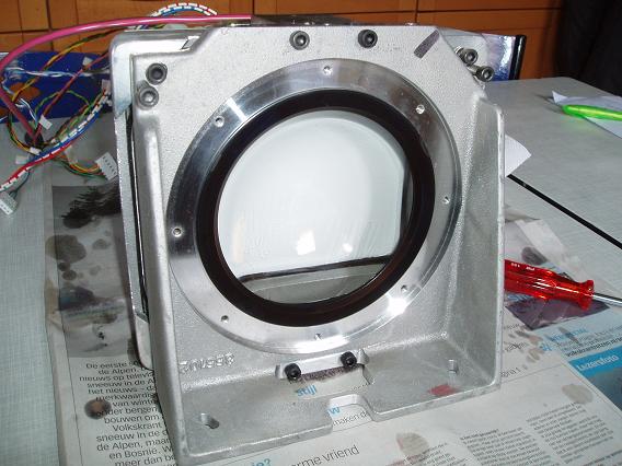

Was wondering if it is sufficient to flush the Green and Blue and refresh the glycol.....or...would it be better to take them apart?
(And flushing....with water or something else?)
"Obviously you're not a golfer"
Posted: Sat Oct 04, 2008 6:41 pm    Post subject:
Arno thats why I told you to take off the back of the LC housing, With it removed you can easily get the metal gasket off and then push the entire bellow with the C Element attached out the front. Then once the C-element and bellow are out you will be able to use a razor blade to separate the Bellow from the C-element, I need to take pics of what I mean. The Lc housing I got form SpeedyAndres has white silicone all over the Bellows inbetween the housings , looks lim,e it was a quick fix for a leak aroud the metal gaskets instead of just tightening them all. Not sure if he did it or it was like that already. But I havent done this yet but am sure its the best way to go for removing the bellow. because once you have room to get to the gasket screws and also now have more room to pry it off the back of the housing you can then push it through the front hole Celement and Bellow.

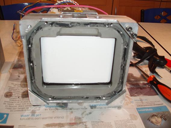

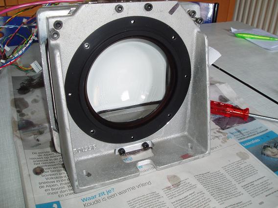

Posted: Sat Oct 04, 2008 11:08 pm    Post subject: Easy methode for C-element removal
Hi Guys, I found a new way that increases the odds of getting the C-element out with less or no damage to the Bellow.
I first said you take off the back LC housing brace but I was wrong, you need to slide it back to give you more
working room to get of the Bellow from the back of the housing. First you need to remover the
pins that are used for Schliemfluge adjustments(Also keep the C-element ring in place till we get
the Bellow off the back)
Screw in to the pin an allen or other screw that fits the threads And Pry it out,
Prying out screw and pin
Pin Removed
Next remove any screws that hold front housing to back and dont loose the Springs.
So after you remove the screws and the top and bottom pivot plates you can move the
housing back to gibe more room to the bellow screws and for a razor or flat screw driver to help
pry it off after the metal gasket is off.
Lc outer Housing slid back to give more room
More room on top too !!!
Now more room for allen key !!! Woo Hooo!
Remove all allen screws, then pry off metal gasket.
Gasket removal
[img]Now slide gasket out of way to front of housing[/img]
Now carefully remove Bellow from back of face plate with blade to start then finger
or you can use the blade all the way around if its on there good!!
Separating Bellow from face plate
Front of LC housing removed from face plate
Now take off gasket
Next remove C-Element retaining ring.
Now fold over the bellow onto the C-element and push the whole thing trough the
Housing hole, do it carefully, but it should be ok and not rip.
Folding Bellow
C-element still attached to bellow
Now you can much more easily get a blade to the bellow and
C-Element to separate them.
Carefully sliding blade between Bellow and C-element
C-Element removed and no bellow damage !!!!!!
i hope this procedure is easier than trying to take the C-element out while the metal housing
is still in place. I think it is.

Posted: Sun Oct 05, 2008 6:18 am    Post subject:
Very clear, thanks!
Have to get these 90deg allen keys.. Wink
By the way, why did you remove the green C from that bellow (replacing it with the new Red? Laughing hope not)?

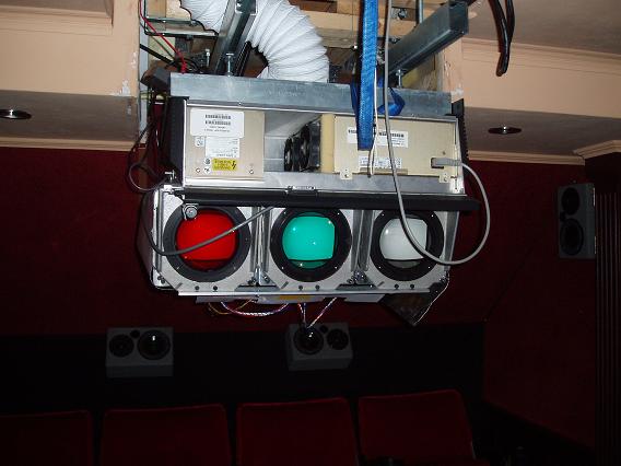

BUT.....everything was worth the effort Wink :

Posted: Sat Oct 11, 2008 5:13 pm    Post subject:
nice set-up Arno, I hope to hang mine sometime this winter
