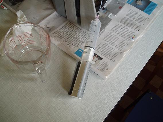

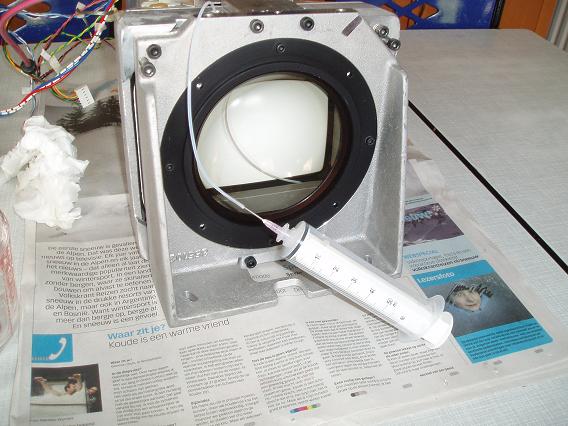

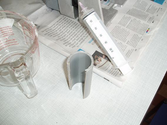

Started on mine today....
 Filesize:  56.36 KB
 Viewed:  8347 Time(s)
 Filesize:  47.39 KB
 Filesize:  46.53 KB
"Obviously you're not a golfer"

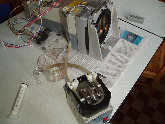

And maybe...I found an even easier way... Mr. Green
 Filesize:  53.14 KB
 Viewed:  8337 Time(s)
Posted: Sat Oct 04, 2008 1:08 pm    Post subject:
Is that a fish tank Pump?!?!!!!! Very Happy
