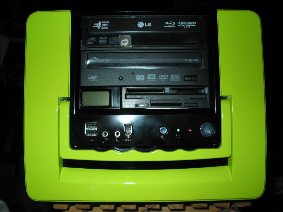

However, I'm getting back to this. I just pulled the PC out of the box ( literally ) and wiped the dust off it. (I know, I know why didn't I dust it before I put it away? ) (shrugs) can't remember, it's too long ago.
Here's the current configuration:

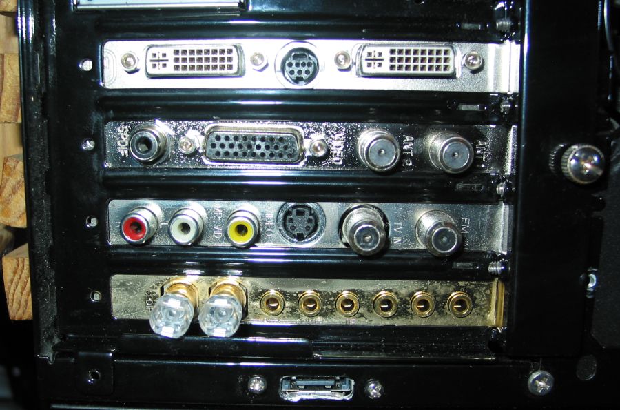

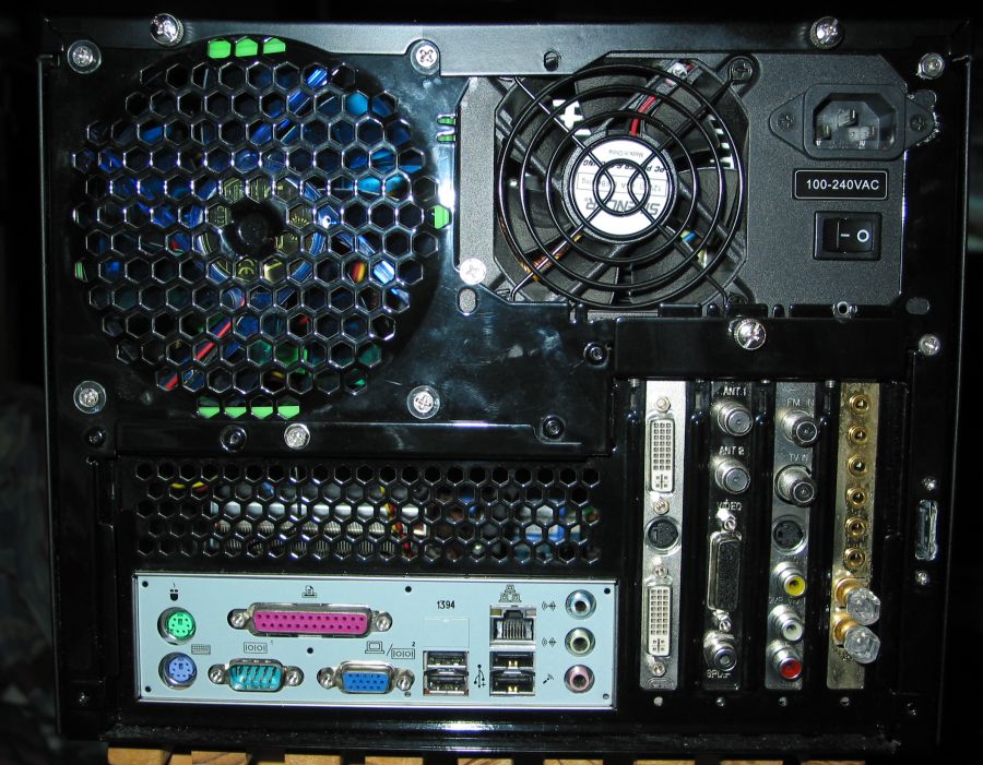

Top to bottom:
ATi 3850PCIe
My HD130 card
Hauppauge PVR500 dual analog/FM card
Auzentech 7.1 card with analog out.
This little HTPC is currently equipped with a dual core AMD 2400+ and 2GB DDR CL2.5 RAM, 2x320gb HDD a LG HD-DVD/ Blueray drive, Plextor 18x DVD burner and a PC Power and Cooling 610 watt power supply.
The biggest issue with this box was no matter what I tried there was no internet connection. PITA for updates and no way to download guide data for BeyondTV.
I had two of these mother boards and both have this issue. I tried USB adaptors x 4, built in Ethernet just a no go.
______________________________________________________________________________________________
That was then.
Now I have a new Gigabyte motherboard MA785GM-US2H
2 sticks of 1GB DDR2 RAM (thanks Andrew)
AMD Quad core Phenom 9850 CPU
and a new AMD cooling fan
I'll reuse the ATi 3850 card as most of the newer cards don't come with HDTV analog out
I'm keeping the soundcard as well.
The MYHD 130 card will come out and get put into another PC
In its place I'll use a Hauppauge 1600 dual tuner card. It's a hybrid analog/digital card with Cable/NTSC/ATSC/QUAM.
That leaves me with a 1x PCIe slot. I'll find a card for that later.
The Hauppauge PVR500 will goto the other PC as well.
I have a Hauppauge external USB ATSC tuner that I may run on here as well.
WinXP pro ( because I already have the licence )
and adding an external 2TB ESATA drive in an external case.
This is gonnna be fun!
