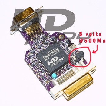

Not all devices can properly power the HDFury because they don't adhere to the HDMI power specification where by you need enough current on pin 14 of the HDMI connector. I've tried an Nvidia 8600 and an ATi 3850 card and neither supply enough power to use the fury past 640 x 480.
This is why the HDFury has a 5 volt power port on the side. You can buy the HDFury with the power supply,
the supply is also available separately.
Scroll down to the "Extra Cables and Power Supplies" and select the corect version of the powersupply you need.
You can check your local electronics stores as well they may have a 5 volt supply that will work for you. You could also forgo the power adaptor and just get a USB power cable with the correct end on it and plug it into a spare USB port on your PC.
This is the way I run it. Again I can't stess enough MAKE SURE you have the correct polarity with the - on the INSIDE and the + on the OUTSIDE. Reversing it can damage your HDFury.
The power port is on the side of the HDFury
From the FAQ's:
The specs say that the HDfury draws it's power directly from the DVI/HDMI line but that an optional +5VDC input is provided for HDMI cables that are over 5 meters (16 feet) or if the source device is unable to supply adequate power. What sort of power supply do I need for this? When do I need to use an external power supply?
The DC jack on the side of the HDfury must follow all these requirements:
- Provide REGULATED (+/- 5%) 5VDC power with 0.5A min DC current -Deliver the power through a small 0.65mm diameter center pin / 2.6mm outer diameter DC plug (like the one often used in cellular phone AC adaptor)
-Provide the correct polarity with 'plus' on the OUTER part of the plug and 'minus' (ground) on the small center pin of the DC jack.
Trying to use an AC/DC adaptor that doesn't follow all these three requirements may destroy the HDFury. This external HDFury powering option is only needed in one or both the following situations:
- The DVI or HDMI cable is using thin gauge copper wires and its length exceeds 5 meters (16 feet).
- The DVI or HDMI source is unable to deliver the 0.5A maximum current over its HDMI or DVI pin #14. This situation often occurs when HDFury is used with cheap DVD/HD players at 1080p60 mode.
Update: The picture quality is often also improved by using an external power supply. Users are reporting that using an external power supply results is a punchier image. For this reason we are highly suggesting that everyone looking for the best image quality possible always order the HDFury Advanced package as it ships with a power supply and some other extras.
So if you get the 5volt 500Ma power supply plugged into that it should clear up the no picture issue.
Power port.
 Filesize:  34.65 KB
 Viewed:  8946 Time(s)
