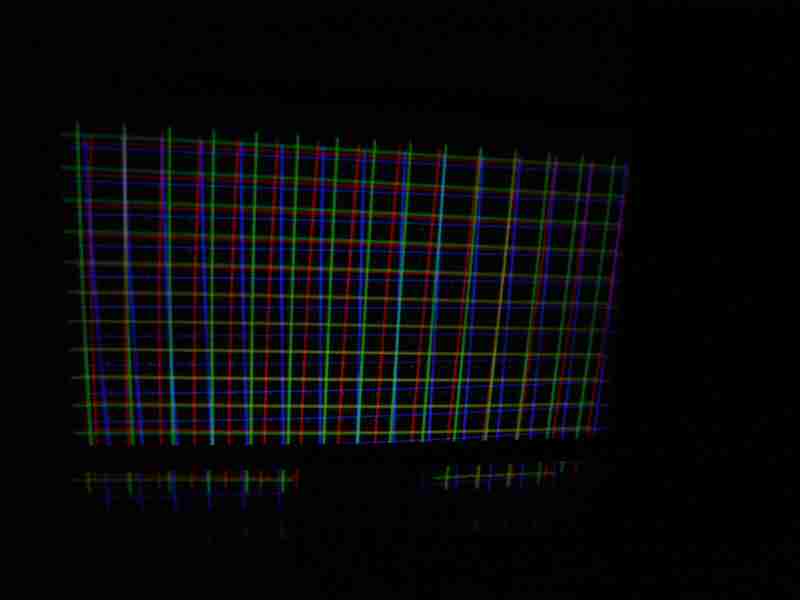

Ok I just have put juce on it Thumbs Up
There's some work to do now cause this is the first time it's alive Mr. Green
First I'll look to red because it is dim ....
Any ideas how to adjust the gain or maybe measure things?

Posted: Thu Jul 24, 2008 8:07 pm    Post subject:
Check the filament voltage, and adjust the G2s.

Posted: Thu Jul 24, 2008 8:17 pm    Post subject:
The thing that makes me wonder is why the horizontal lines at brighter than vertical.
Some form of beam current limiter?
Arno P
Joined: 01 Jan 2007
Posts: 282
Posted: Thu Jul 24, 2008 8:18 pm    Post subject:
Squeezed pattern?

Posted: Thu Jul 24, 2008 8:32 pm    Post subject:
Sorry I meant the other way around. Vertical brighter than horizontal.
Squeezing should not make any difference in brightness.

Posted: Thu Jul 24, 2008 9:02 pm    Post subject:
You need to do as Curt suggests and check the filament voltage. After you've applied the fix/mod for that, then null all the settings and start from square one. Keep in mind not all settings will null when you select a Full Reinitialization from the menu. You'll have to go in and zero/null those manually...then start your setup from square one.
It's exciting to see them light up for the first time tho isn't it. Thumbs Up

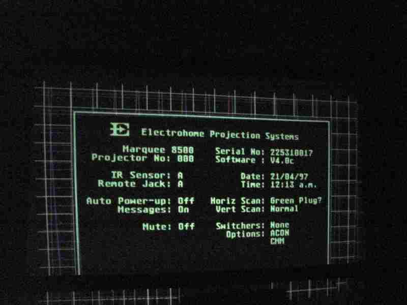

Posted: Thu Jul 24, 2008 9:20 pm    Post subject:
Ok here are some all-wrong pics Confused
I've put HD300 lenses on it to start with.
The picture looked like meant for a curved screen, it was imploded egg shaped Shocked
For now it seems that the convergence is for all colours together, I want to setup each color seperated.
Also the chassis is reported as a 8500, I don't know if this is because it's a Vidikron Vision 1 .....

Posted: Fri Jul 25, 2008 12:42 am    Post subject:
The menu pic that shows Horiz Scan: Green Plug? is trying to tell you that the green horizontal deflection yoke is plugged in opposite of the other two. Turn projector off before you fix that.

Posted: Fri Jul 25, 2008 12:37 pm    Post subject:
The PJ info is kept on a chip on the back plane board. This may have started as an 8500 and built up to a Vision one. Another option is the back plane was damaged by a Glycol leak and they replaced it with one form an 8500.
Or worse you got and 8500 and they said it was a vision one, and put in 9 inch tubes. See if your serial numbers match from the software screen and the sticker on the front.
I thought i was getting a refrence 8 and got a striped down PJ with parts replaced from an 8000, some times you have to ask for pics of all board part numbers
when buying a PJ.

Posted: Fri Jul 25, 2008 8:02 pm    Post subject:
Ok I've got BIG BIG troubles now Embarassed Crying or Very sad
I changed the green horizontal connector (on the cable) to get rid of the error in the menu and that worked out ok.
The green pattern was more shaped like red and blue so all looked fine.
The error in the menu was gone and it showed 'normal'.
Then suddenly there were 3 flashes and loud snaps on the back near the neckboards Crying or Very sad
The blue tube neck seems to be broken as I can turn and move it's neckboard a little Shocked
What the hell has happened, the filament voltage still is as it should be and the others (5V, 15V etc) too.
I'm an experienced (Sony) crt user and I've never seen this before Confused
That the repair will be very expensive should be clear, what a bummer!
First I want to know what did go wrong as I can't see any broken parts on the neck boards and the other boards ....
