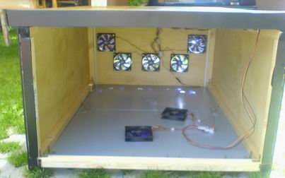

Posted: Sat Jul 19, 2008 9:04 am    Post subject:
I will color the second top plate of the hushbox today.

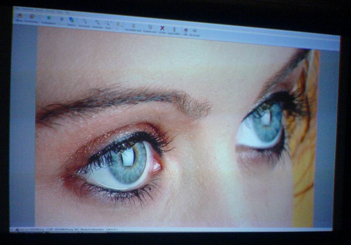

ElTopo, your "eye" shots still need lots of work.
Here's the same pic on my NEC 6PG Plus at 1920x1080i96:
"Pete's" eye Smile
Obviously colors are off (mostly due to camera settings)
Kai

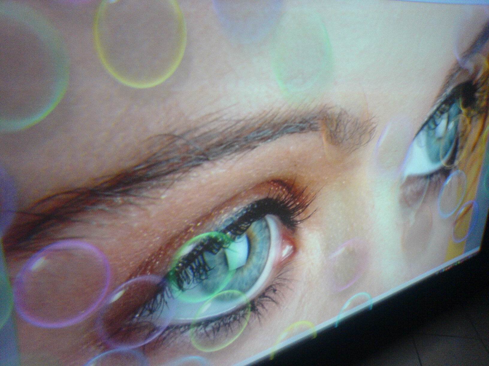

n@t
Joined: 02 Apr 2006
Posts: 63
Posted: Wed Jul 23, 2008 7:45 pm    Post subject:
my two Eyes on the curved...
A close up...
My cam is bad Sad
