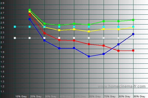

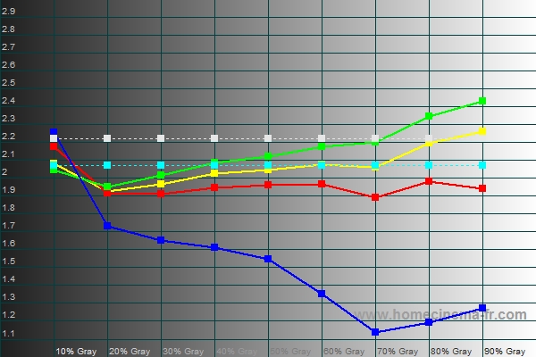

Posted: Mon Jun 09, 2008 8:15 pm    Post subject: Same questions here
Don't feel alone bubsnews. I have the same problem (See before and after). I've asked this question here recently but I have found that there aren't too many offers to help (other than kal who wrote the great guide and whose time is, I'm sure limited). I suppose this is because many don't want to post on the forum just exactly how they make all the graphs line up properly (self-preservation). So, while having all these tools is cool, this is probably going to be primarily an individual effort. Crying or Very sad
This was much easier before HCFR. Getting grayscale flat was not really a problem. Now that I can see in charts that I was also messing with the overall gamma I'm really confused. For me the gamma went from over 2.4 to less than 2.1. Mad The image is noticably more washed out and less punchy but I don't know how to adjust it other than trial and error.
I've pretty much resigned myself to figuring this out by trial and error at this point as most of the folks who know how to do this typically don't reply. If I figure out any tricks I will be sure to post results Wink

Wow, what a dramatic difference. I feel my image is flat and washed out now too but I believe that Kal has straightened me out on what to do to correct it. I'm lucky as I have a video processor and I can boost gamma a bit (I don't think my fall in gamma is anywhere near the dramatic decrease that you have though). Do you have any ideas at all as to how to correct for this and not lose your greyscale calibration?
Wouldn't it have to have something to do with the way you adjusted contrast and brightness? I was able to go back and adjust contrast and brightness without using the calibration tools, just eyeballing it for now, and my image looks much much better. I'm going to run a calibration results before changing anything and I bet my gamma is a lot flatter and much closer to 2.2 as well.
Before, my gamma was always a bit low (of course I didn't know that before but I'm pretty sure I can boost it with my HD3000 and then re-calibrate and get it up close to 2.2) but very flat in all colors. After my initial attempt at calibration, my gamma was low and sloping off the chart at the higher IRE's. Kal helped a lot with explaining that to me. I'm sure he would have some excellent advice for you as well.

My concerns are down to two. I really need to try again with contrast set somewhere between zero and +7 as I think zero is too low and obviously +7 is too high (the dang HCFR software keeps crashing after about an hour of calibration and it is too hard to remove the sensor from the mount without having to completely start everything over, not something I feel like doing after calibrating for an hour or so already).
The second concern is why the gamma reading isn't as flat after calibration as it is before calibration. It's odd that setting the HD3000 to +3 gamma flattens the gamma curve but a -2 gamma or zero gamma setting causes the curve to slope dramatically. If anybody has any advice, I'm all ears.
I will attach the three files.
Thanks and good luck everybody,
George
t3.chc
gamma -2
 Filename:  t3.chc
 Filesize:  17.78 KB
 Downloaded:  6 Time(s)
t2.chc
gamma zero
 Filename:  t2.chc
 Filesize:  71.07 KB
 Downloaded:  3 Time(s)
tb4.chc
Gamma +3
 Filename:  tb4.chc
 Filesize:  71.05 KB
 Downloaded:  4 Time(s)

I was interested in just what this Optoma HD3000 was, as I'd never heard of it in the Video Processors forum on the "A" site. I Googled it and found this review by Tom Huffman: http://www.avsforum.com/avs-vb/showthread.php?t=704674
His initial impressions were VERY rosy, but then in a subsequent post he backs off a little - but still, it seems like a pretty good VP. It has a Gennum VXP processor in it.
Just a couple of observations: Earlier Bubsnews you complained that you weren't getting much "help" with calibrating your DLP projector. That's probably because this site is overall primarily a CRT Front Projector site (analog) and there aren't too many digital guys here. Also, my impressions from using HCFR (on my Marquee) were frustrating at first. A colorimeter is a pretty technical toy and it just takes a lot of practice and MANY passes at greyscale calibration to begin to get stuff figured out. After all, there are professional calibrators out there - not that they use HCFR - but it is a skill that they use to make their living with.
But it seems that you are making good progress now.
My 2 cents,
Gary
Posted: Tue Jun 10, 2008 6:14 pm    Post subject:
Why do you think zero is too low? You're getting around 12 ftL which should be plenty bright, but brighter may be better I suppose (as long as your 90/100 IRE numbers don't crush together).
That's an odd one. No idea as I've never used your projector or video processor.
