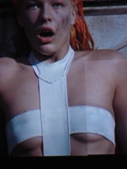

FWIW I leaned a spare scrap of DW against my BO screen. At first I didn't think it was noticeably different -- then I sat down in my viewing spot. It made a big difference then! Clearly the gloss on this stuff is reflecting a lot of light directly to the hot spot. Hm. Which is more likely to make ripples visible...
This isn't a great screen shot but you get the idea...
