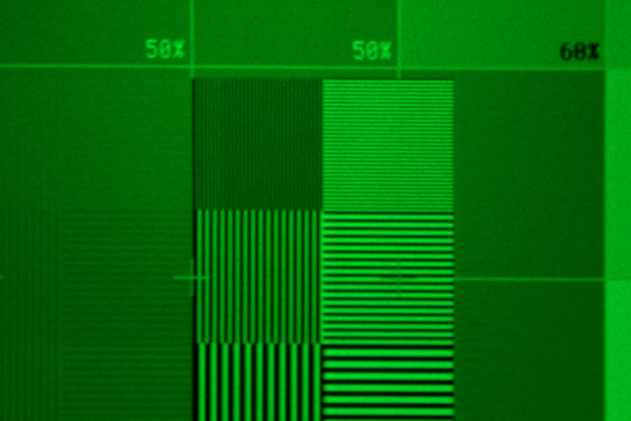

OK, that's good to know, Cliff. Because, after I turned off ABG, and cranked up G2 to get good shadow detail back, now the ABG line is showing up again (although not nearly as bright as when ABG is on. That tells me you're right about bad setup. I think I'll do full setup again, then.
Assuming what you say is true about ABG not being in the active image area (I trust you, big dog!!!), then that means you have to do geometry on the internal pattern with the borders extending WAY beyond the 16:9 screen, yes? As in, a foot above and below - at least?
The first time I did it, I set it up so the internal pattern (raster, yes?) went to the edges of the screen. That was totally unusable with 1080p. Totally. All sorts of trouble - raster wrap, ringing, distortion, etc. So, the second time, I set it up with the second grid line hitting the edge of the screen on top/bottom, and the first box about half off the sides. That gives almost acceptable 1080p performance. Set up like that, I just have a little ringing on the left side and some wavy geometry.
Obviously, I need to do it again, but with way more off the sides of the screen. What a pain, though - won't all my outside zones be completely off the screen? How do you even set it up right with the image hanging a foot off the screen - on a black wall, no less. Maybe I don't get something. I'll take any advice I can get at this point. I'm learning.
I do have optical focus and scheimpflug NAILED, though. Using the Guy Kuo 'index card' method, I think the focus plane might be slightly in front of the screen. It's so close it's REALLY hard to tell. The phosphor grain is sharper than the image, which means I probably have some EM work to do - maybe. It's damn good, though. It just completely DESTROYS the image I used to get out of the old 1271. I'm so excited. It already looks AWESOME and I have quite a ways to go.
I attached a pic of the center of the SMPTE pattern I said I'd snap.
SMPTE pattern, screen center, 1080/60p from PS3.

Posted: Sat May 24, 2008 2:27 pm    Post subject:
Sorry, I mean the line (bow) should not go into the used "picture" area. My bad. Very Happy
That shot looks great!!!!!!
