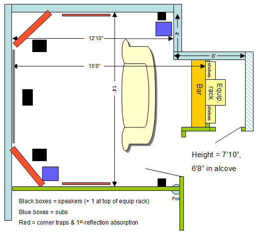

Poor intelligibility of the center is more often the room. Are you getting all first reflections? If so, it might be your center speaker. Generally, center is already mixed higher with a boost on dialog. Taking the center down 1 or 2 db can level it all out and make the front sound stage a little bit more involving.
Not all, no. I have no treatment on the ceiling, and only carpet on the floor. But I have 2" OC703 mounted 2" off the wall at the left/right reflection points. I also have 4" OC703 covering the front two corners, floor-to-ceiling -- roughly 4' x 8' -- for bass traps. See pic. Blue walls, and floor under the pad & carpet, are concrete.
I also have a cheezy center, which is very likely a big part of the problem. Embarassed
