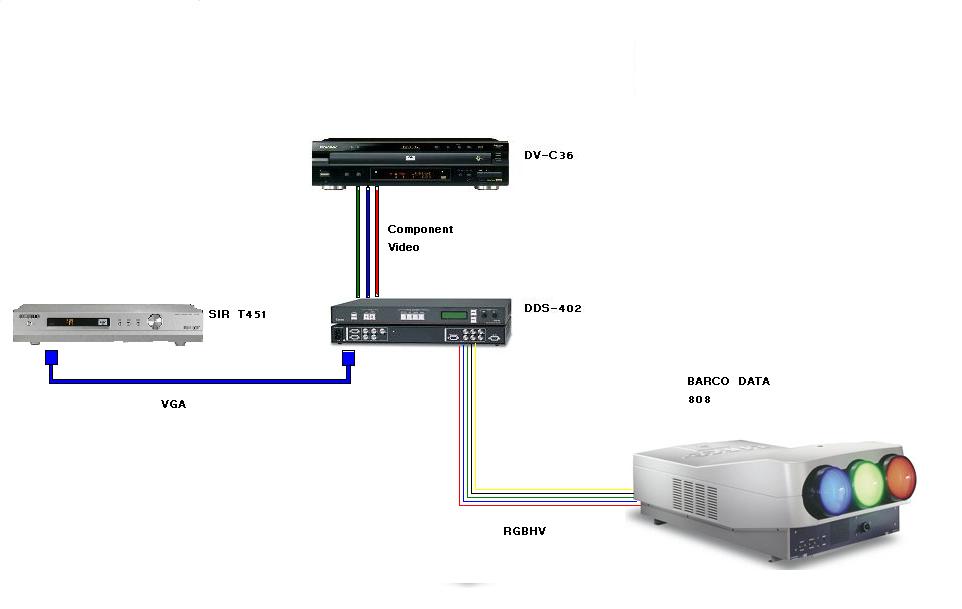

Just as a quick reminder, this is what I using in my setup. I left the audio out for simplicity.
It's pretty basic for a starter system.

About the only thing I would suggest is
replace the extron with kims transcoder. I have had a large number of extron boxes and they all add noise.
Unless you need the scaler - I have replace all my scalers adn replace them with the PS3 for dvd and run HD cable though the transcoder straight.

If I take out the Extron, won't my dvd's that I play just be basic 480i/p depending on the setting of the player? I have no use for a blu ray at this point since I don't want to change my existing reciever just to get lossless audio (not important now) The players that I have seen that had 7.1 analog outputs did not have internal true hd/ dts master Thumbs Down (so far). So although you say I would get noise...wouldn't the picture still be better than 480i/p if it is scaled to a higher resolution? The transcoder says it will allow you to boost gamma levels, but does it upconvert the resolution as well? If so, then I will buy it and remove the extron once I return home....or can I add it to the extron for better picture quality? Thumbs Up I'm still new to this game so if you smell the milk on my breath, I get it honestly. Thanks for the suggestions.

The PS3 has an amazing scaler - it will scale DVD to 1080i/p or what ever you want to run.
If you already have the 402 - use it if not I would say look into the PS3.
Not sure about the sound - i am currently just running the R/L outputs as my reciever does not have HDMI

Yes the Extron is already in my system, has been since May. I don't see a need for a PS3 even if it does do a great job at scaling, it would be a waist since I am not a gamer and it can't do what I want as far as audio processing goes (7.1 analog). So I'll just stick with the extron until another/better scaler comes along at a reasonable price. My main concern is getting my projector set up after my return. Thanks for the advice though.
